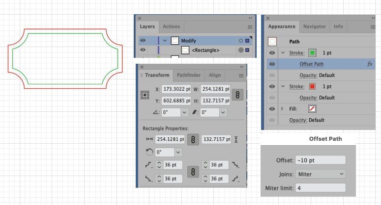

Yeshayac, If I understand you correctly, you are wanting inverted corners with an inset stroke and easy edits to modify.
Here are the steps I used. It’s just one rectangle.
With your rectangle tool, draw a rectangle. (shown in brown)
In your Transform panel, select inverted corners. Type in the radius you want. I choose 24.
While still selected, Appearance Panel, Add a new Stroke, located in the flyout menu, shown in cyan here)
Give that cyan stroke an offset effect. (Effect>Path>Offset. Here I use

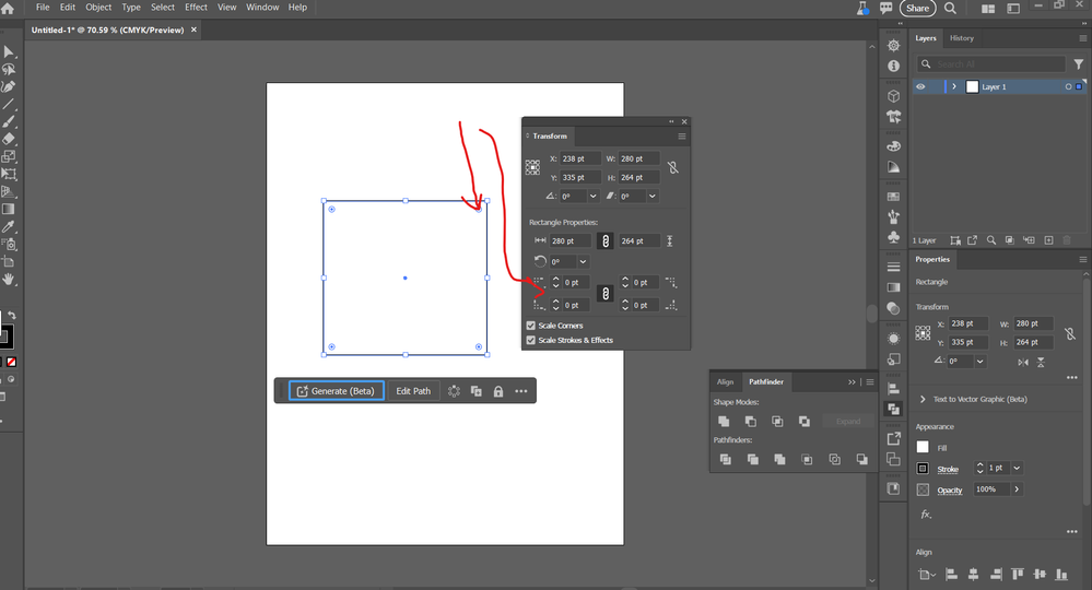

As Bobby Handerson mention you can use Corner widget. See capture

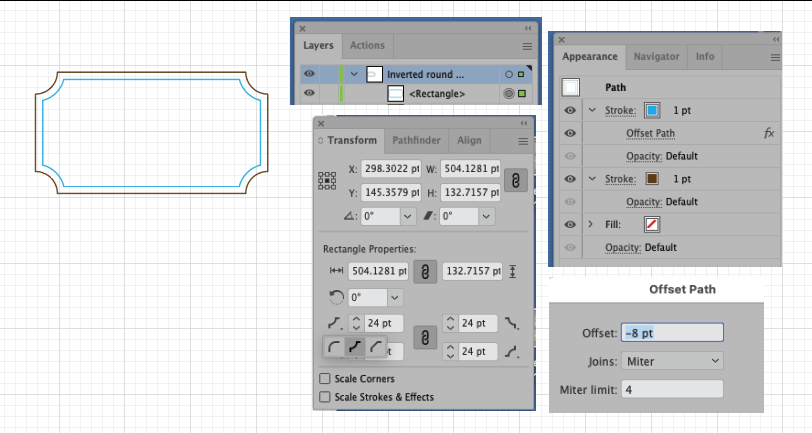

Give that cyan stroke an offset effect. (Effect>Path>Offset. Here I used -8)
OK, say you want to modify. No problem. Everything is still live.
See the screen shot below with the new settings.

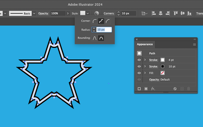

It works on any object that has corners, not just shapes. Show the live corners in the control panel.
