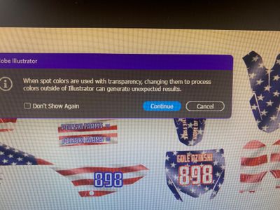

Spot colour used with transparency
Explorer ,
Apr 15, 2021 Apr 15, 2021
What does this warning mean

Community Expert , Apr 15, 2021 Apr 15, 2021
This means you have colors that are specified as spot so the would in print separate in an ink other than the process of combining CMYK. Though printing for example a spot color of  f field of PMS 320 at 50% is nto an issue, a problem occurs when you have for example a blending mode as that spot has to be converted to CMYK, in the conversion there will likely be innacuraccies.
If you need more help please provide screens shots of your individual separations preview for each spot color you have. W

It means what it says - any conversion to CMYK may yield a drastically different color result. unless you are 100% certain it actually gets printed with the colors you defined at the given densities, you may want to dig out your pantone swatch and find substitutes that giver the same coloration without relying on transparencies, as clearly would be preferable for package printing under most conditions.

Thank you - My first time designing packaging.
I was hoping to keep the design to four colours which I've achieved and yes, I have used Pantone for the colour choices
If you need more help please provide screens shots of your individual separations preview for each spot color you have. Windows >. separation preview is some I recommend you like into to explain what is going n here.

WHEN EVER I CREATE A DESIGN IN ILLISTRATOR . WHEN I GO TO SAVE AS, I\THAT ERROR POPS UP . AND WHEN I SAVE IT IT CREATES MULTIPLE CUT LINES, I DON'T KNOW HOW TO MAKE IT CUT ONLY ONCE?

Please tell us exactly what you are doing step by step and exactly how you are using spot colors in this.
Besides: It's not an error message. This message just alerts you that something could happen.

yes and what happens is it creates multiple cut lines. Anything i create on illastrator or if im doing a bought template. i get that message, Now if i create something on bazzarrt, it doesn't do it?

Check the separations preview to see if your spot colors are still separated as separate plates.
