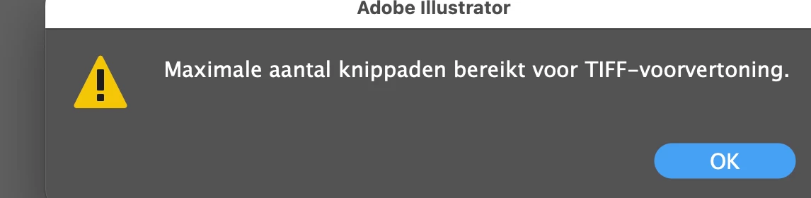

strange warning at safing file
  • December 10, 2024
  • 327 views
Every time I safe an Illustrator file with several pages, I get a warning saying "Maximale aantal knippaden bereikt voor TIFF-voorvertoning", in English that would be someting like "Maximum number of cutting paths reached for TIFF-preview". Dies anyone know what it means and how to prevent it or what I should do? There is no "Don't show again option".

Knippaden = clipping paths.
Do you use a lot of clipping paths in your document?
As it says it is used in building the preview. How do you save your files?

December 10, 2024
Thank you!
As far as I know, I use zero clipping paths.
But I do safe EPS with TIFF-preview and when I switch that off, it seems to solve the problem!!!

Thanks again. I am a bit old fashioned when it comes to Adobe software.
These aren't final files, just working files. I guess  .ai  would be just as good or even better.
For the final output (to printer, client, etc.) I indeed use PDF most of the time.
Yes, AI will be better.
If you currently save an EPS in Illustrator, it will also save an AI version in the file to be able to edit it with all the bells and whistles of the current version, so you are actually opening the .ai file instead of the .eps part.
