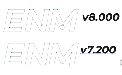

It's because of how the font outline was constructed. Not sure if this is laziness or a missed step on the designer's part, but this has come up a few times, especially with fonts from independent font designers on Google, and sometimes it depends on the VERSION you have downloaded. In fact, in the case of Montserrat, if you download the same fonts from: (https://www.fontsquirrel.com/fonts/montserrat), the font is properly constructed and will work fine.
As illustrated below, the font outline at left is from the version available from Google right now (v8.000) which uses overlapping shapes and the one on the right is from fontsquirrel's website (v7.200) which does not have the issue.
 As I said, I'm not sure if this was just a "missed step" when they created the final outlines in v8.000, but it's what's causing your issue. I can see how creating shapes this ways works for variable fonts, but it shouldn't be that way in static versions.

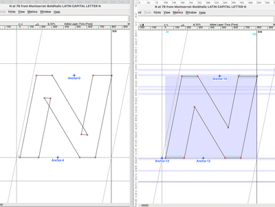

No they don't. In fact, Font Forge (which is the one I'm using these days) talks about how it's easier to work with separate shapes when designing a font but warns that they shoud be simplified on final output (FF has a "Remove Overlap" function). My guess is the designer forgot to do this on their v8 which Google is offering, since it was very definitely done on the v7.2.

No, not an Illustrator bug. If you outline one of these static fonts in InDesign, it will show there as well. I've checked with a few font creation apps over the last couple of days and have found, (thanks to FontLabs for clueing me in)  that Variable fonts are "converted" to outlines on the fly by the System and Applications that support them, and overlap removal is part of that process. Hence, outlining a variable font in Illustrator looks fine. Static fonts, however, are rendered at the output stage (by a Printer RIP, etc), so the overlaps are NOT removed and when outlined the overlaps show, as it's showing what the printer wil do with it.
I've now looked at Font Forge, FontLabs and Glyphs and all these apps recommend removing overlaps on static fonts, and most font creators do this automatically when generating final instances. Not all do. So, again, I suspect that a step was missed when generating the v8.000 versions of Montserrat that Google is serving. The version that Adobe Fonts is serving (v7.2000) is fine.

I've heard back from the designer. She sends the masters to Google and they create the instances, so it's Google that may have missed the Remove Overlap step on the v8.000 static outlines; It was definitely not her intention to keep overlaps, except for the purpose of creating the variable instance. She suggested the OP get in touch with Google if they wanted to persue it further.
Jun 03, 2022 Jun 03, 2022
@Katie24222578syyt
If you've been reading all of this back and forth, the answer for you right now is to ditch the Google versions you have and use the version of Montserrat that's on Adobe Fonts, or download the family from fontsquirrel.com.

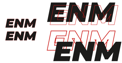

"What I think is pretty astounding is that if you have the same live type object in InDesign, it looks good as long as it is a live type object"
Yes and No. Depends on where your stroke is located.
InDesign's default is to add a stroke to live type on the outside of the stroke. It does this by actually creating a stroke double the desired thickness and placing it behind the fill in the stacking order when it goes to print. On screen this looks like evrything is fine because the fill blocks out the fact the stroke behind it is f**ked up.
However, if you change the stroke on the live text to center, ID creates a stroke of the desired width but brings it in FRONT of the fill in the stacking order, hence you see the messed up stroke.
In my example, I have text with a red outline of 1 point, centered on the top one, and outside on the bottom. Once you split them apart (I opened this in Illustrator from a PDF), you can see that the bottom one has a 2 point stroke with the fill element on top of it, and you can see that the stroke is also messed up.
