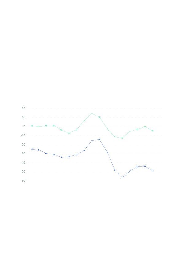

I am creating a line graph and I want to style each line differently. i.e one line blue with round points and one line green with round points.
The have tried using the design tool but I can only get it to use 1 style at a time.
The graph is quite big and trying to select each individual element to too difficult, so I need a simple method.
How do I style each line differently?
Thanks

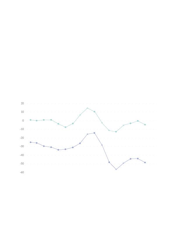

Hi Monika
Apologies for being so stupid! I never realised there was a Group Selection Tool!
I have worked out how to change the line colour and style and even change the colour of the square.
I'd still like to be able to turn the square into a smaller circle, but maybe I should quit while I'm ahead!
Many thanks for your help
Mark

Use the graph's legend.
With the group selection tool, click 2 times (not a double click) on the line in the legend to select the graph line associated with it. Then apply the styling.

Hi Monika
Mark
To turn that square into a smaller circle:
- select and copy the square
- paste it somewhere else in the file.
- draw a circle in the size and color you need
- apply no stroke no fill to the square.
- make sure the square is behind the circle
- select square and circle
- Object > Graph > Design: New Design
- select all the squares in the line using the same method as with the graph line segments
- Object > Graph > Marker: select the marker you want
