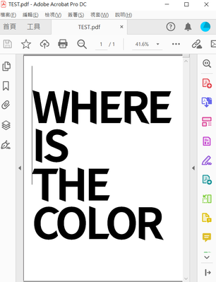

Hi there, as title, a color background was set to my AI file.
saves as a copy to PDF.
and it turned out like this...
the funny thing i tried was down the size to the color.

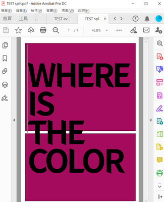

and it works finally.
Judging my design? How Artificial Intelligent it becomes...
so i split my color into 2 pieces and it still works...

as shown above, it is an retangle and 2 retangles of color.
my question is, no matter what people call, why the retangle of color was missing in PDF?

They are on the same layer and as screencaptured without any extra settings...the PDF failed.
and again when I size down the colors....it shows in the PDF

Hi!
Thank you for the answer and posting with screenshot, my "PRINT" setting was checked.
Found the issue by opening in the browser. PDF is fine in CHROME but not OK in Acrobat, assuming the issue from the Acrobat bug in my computer...(i will upgrade my laptop and system soon so...)
