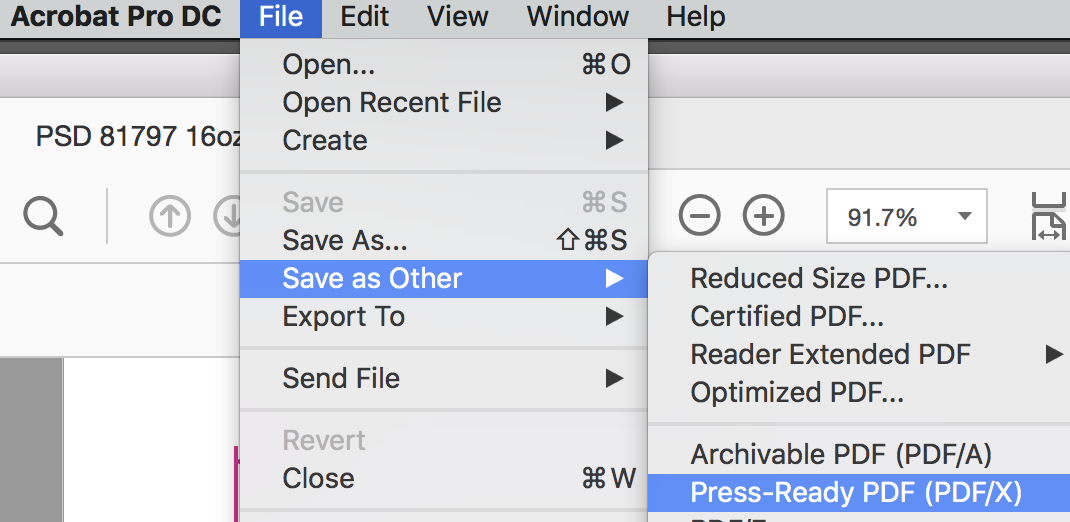

HI Jim,
Try: Save As Other >> Press-Ready (PDF/X) then switch here
When I switched from 4 to -1a the layers were gone. For me default was 4p. Sorry my test did not have live fonts, as title of your post suggests live type is your issue. Went with PDF I had as was trying to help during workday.
Did you also try:
file >> export >> postscript
then distill that to  a PDF/X CMYK
Monika, might be more familiar with exactly what PDF presets outline text and remove layers, which may be helpful to unravel this mystery.
