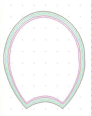

I think the easiest way for me to explain this is :
Say I have 4 shapes with curves, each one a bit larger than the other.  Each shape is a different color and I want them on individual layers.
What is the easiest way to trace each shape on each layer?
I tried the image trace, but it traced one and the others disappeared.
I'm guessing this is a simple procedure, but I want to shorten the learning curve.

Publication2.jpgI want 4 - 8 different sizes, each in a different color on their own layer.
Apr 15, 2017 Apr 15, 2017
Sorry! My answer was general and I post it before your explanation.
For this kind of object use the blend tool instead of "Image Trace" How to blend objects in Illustrator

Apr 16, 2017 Apr 16, 2017
I've found that I can use the line segment tool and go around the first object on layer one.  Then use the curvature pen to round things out.
Go on to the next size on the next layer and so forth.
It's working in Reader the way I want it to.
However...
The problem with that is the points don't precisely connect.
So I'll try again with the pen tool.
Next question I have, is how do I get rid of the lines I'm tracing over?
The lines I want to delete are from the image I saved as a pdf from my drafting program.
How do I delete them alone, without deleting my new lines ?  My tracing is over them fairly precise and I can't see them.
