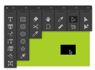

In Adobe Illustrator 27.9 (also in Photoshop) on macOS 14.0 I'm unable to click in transparent areas of panels.
Anyone seen this before?

Thanks, I updated my post as I'm working with macOS. When I break the panels apart I still can't click inside the transparent area which surrounds them, the pink area in the screenshot. The panels inside the pink area work but I can't drag them to a different location.

When I click on that area nothing happens, I can't click to select items there nor start there to make a selection by click-dragging.  On my second monitor I get the same result, many open panels are located there. When I clicked the transparent area I could switch to the desktop or the active app behind the panels. This doesn't work anymore.

For example, when I connect tools horizontally like this, there are areas that cannot be manipulated.
If I just arrange them without concatenating them, this operation error will not occur.
Also, when I connect three or more palettes in the same way, there are areas in one palette that cannot be manipulated.

The difference is whether the tool palette is connected or not.
There is no problem if the tools are not connected to each other.
