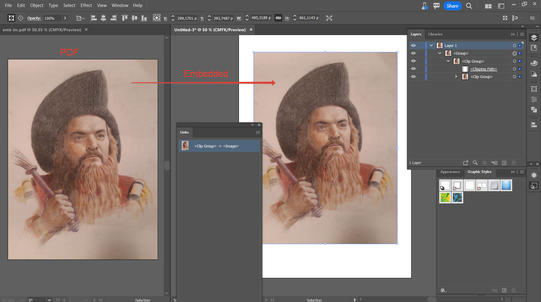

Could you please show the screen with the Layers and Links panels expanded?
If content is sensitive, you can zoom it to show just part of the artwork, we need mainly panels to say something helpful.

As far as I can see here are 2 things:
1. You placed the images without the Link option. In this case Illustrator embed the image into the document and break all links to the original (including its name).
2. The clipping masks may be created by yourself or by the program itself if you place, for example, PDF format. What format have the images?

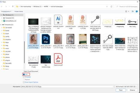

1. To place a linked (unembedded) image, place it with the Link option turned On:
It does not include the image in the document but creates the link to the original image and its "avatar" in the artwork. So you can edit the original in its own source program any time, your doc is not too large, but if you want to move the artwork anywhere you need to move the external image as well.

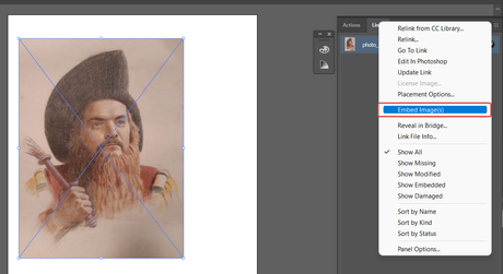

The linked image has some marks: it"s crossed by diagonals and has a link mark ("chain") in the Links panel.
If you want to embed the image, you can choose the corresponding point in the Links panel menu:
Then you'll get an image that is totally included in the document, link to the original will be broken. You cannot lose it when move anywhere but its size will be added to the doc size and you can't edit and update it. after any editing of original you will need to relink it:
To restore the "Linked" status, you need to relink the image with the "Link" option turned On.
Now about your doc. This happens when you place the PDF file (it may be Photoshop PDF or Illustrator PDF as well). the embedded PDF receives a clipping mask like some "capsule" for its content.
so to avoid this action you can place the file with the Link option or save the original raster images in another format (PSD, TIF, Hi quality JPG etc.)
