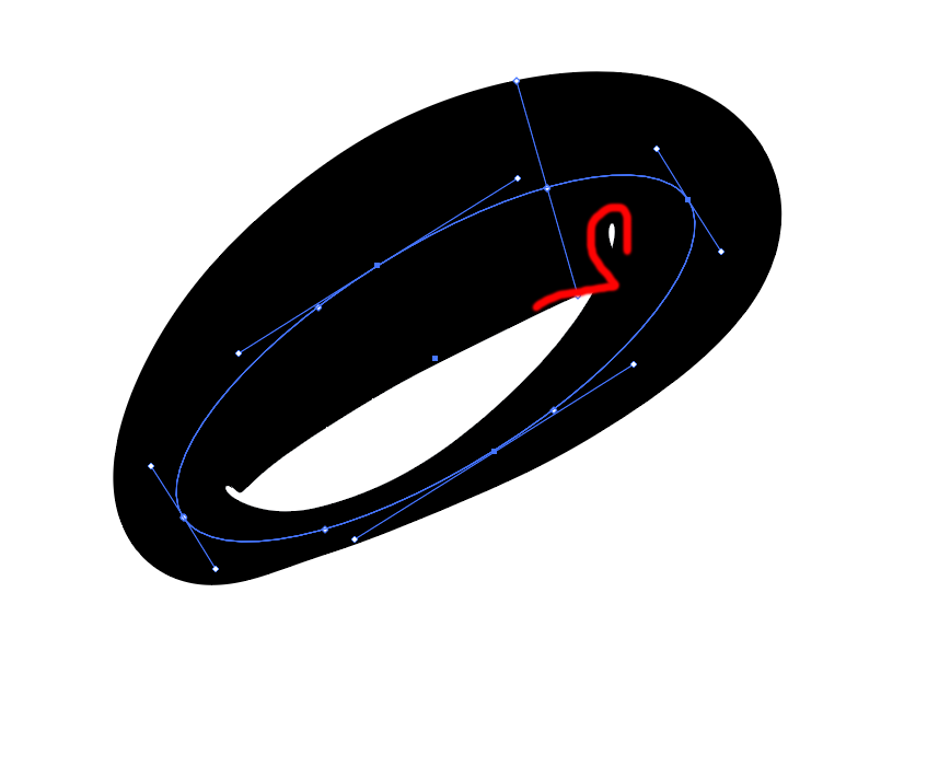

For me on 2015.3 mac 10.10.5 I after switching to anchor point tool
strange thing will happen in tights quarters, I drew in red the shape of the path
