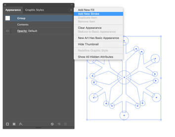

If I understand you intent correctly, then Outline Stroke is not what you need.
Make a group of your snowflake objects, Add New Fill to the Group, and fill it with White - then add New Stroke to the Group in the Apperance Panel, and move it behind Contents in the Appearance Panel.

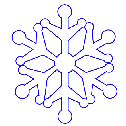

What Im going for, the type of border:

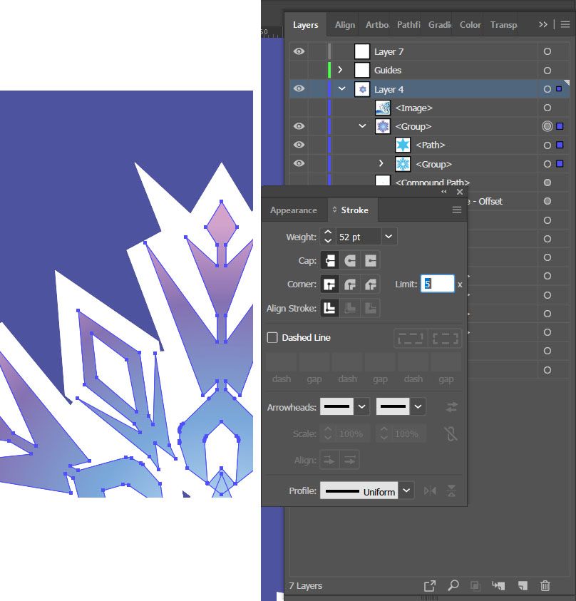

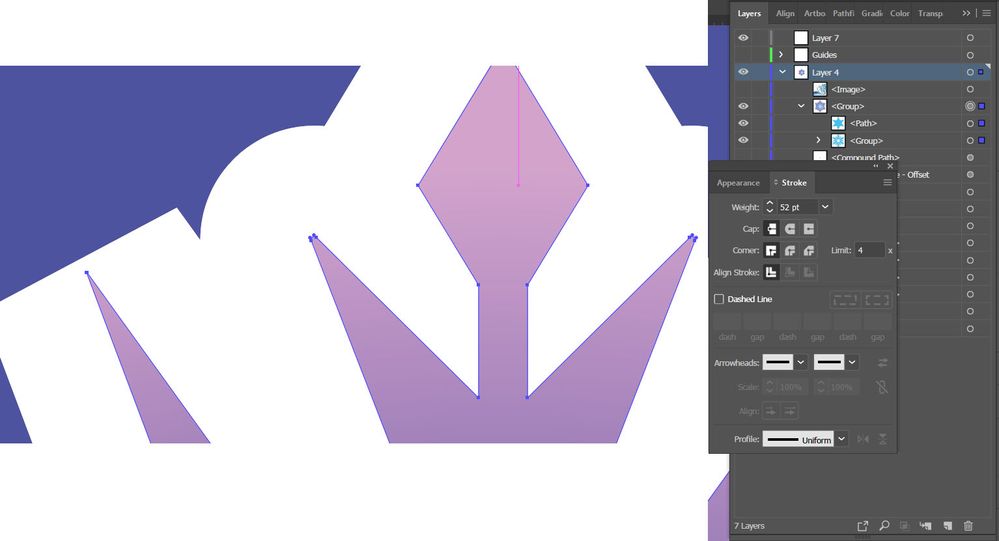

What it looks like with my orrginal spae, which for whatever reason had extra anchor points. Some had round tips, and some had square tips.
This is what it looks like when I correct the issue and eliminate extra anchor points. Tips are still cut off:
This is what it looks like when I increase limit to 5. Some correct themselves, but some tips are still cut off:
This is what it looks like when I increase the limit to 8. All tips are corrected, but the thickness is far too inconsistant:
The blue lines represent the desired thickness, where the red represent the spikes are way too far out.
Im hoping that there is an djustment, setting, feature I just not aware of yet to acheive a nice even border around the base shape, like in the refference. I understand that in the reference image, they probably didnt have a "border" but that the whole thing is one shape and the notched out shapes are seperate. But if I have to do that, it's twice the work. For anyone that might attack me as Im lazy, Im not. If twice the work is the only option, then Im A-okay with that. I've spent hrs on detail work when necessary. But I value my time, which is limted as I suffer from chronic migraines. So, if there is a more efficient way of going about something, cutting out steps, I want to know.
