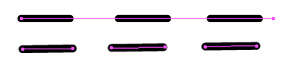

I need to transform a lot of dashed (single) lines into separate lines... Who can tell me how to do this in a few clicks. I don't need an outline of the dashed line. So the black dashes I need, the white in between the dashes I want to loose.
A little complicated to explain... See the example. I need the second lines.

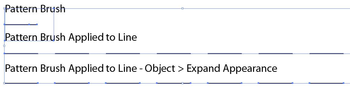

I know this is an old post. Just to share my method. I found the best solution for this problem :
1- create a single line i.e. 12pt long 1pt thick
2- make a pattern brush from the line
3- In pattern brush options dialog box, put 50% in spacing box.
4- apply the pattern brush to your desired shape.
5- you can still adjust the gaps in spacing box and hit apply to stroke
6- You can also change stroke weight !
7- go to object -> expand appearance.
Done !

Jul 22, 2010 Jul 22, 2010
Object --> Expand.
Mylenium
LEGEND ,
Jul 23, 2010 Jul 23, 2010
Object Expand (Stroke) gives you this:
Not quite what the OP was asking for.
Is there another way?
New Here ,
I used a trick and waiting now to see if production will accept...
I gave the lines a weight of 0.0001 pt... and then used expand transparency.
Hopefully it works!!!
Thanks for the replies.
Ellen

Don't use a Dash stroke. Use a Pattern Brush consisting of a short open path. Widen the Brush's invisible tile path to create the desired gap relative to the dash lenght. Apply to paths, then Expand Appearance.

Make a line for example 5mm --> make a pattern brush from line. Select the the other line and apply the brush on it. After this at Stroke menu apply a dashed line and last expand appearance.
