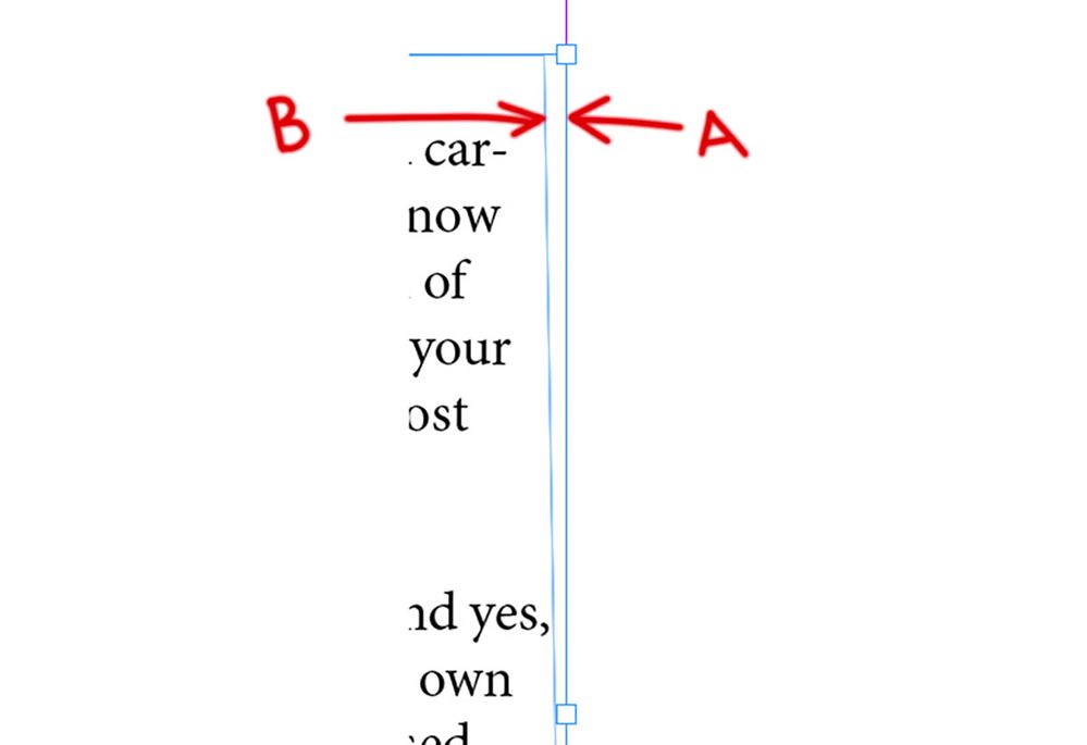

It's so easy to 'touch' the cursor to a surface in the document while editing text and now to find out I accidentally rotated, not the bounding box 'A' but an internal box 'B' that seems to be the 'level' or 'rotated' state for the text itself. This is beyond me to know how to restore this as all of the text in this document should be level and I need to restore it. What do you recommend? Is it possible to bring this back to level?

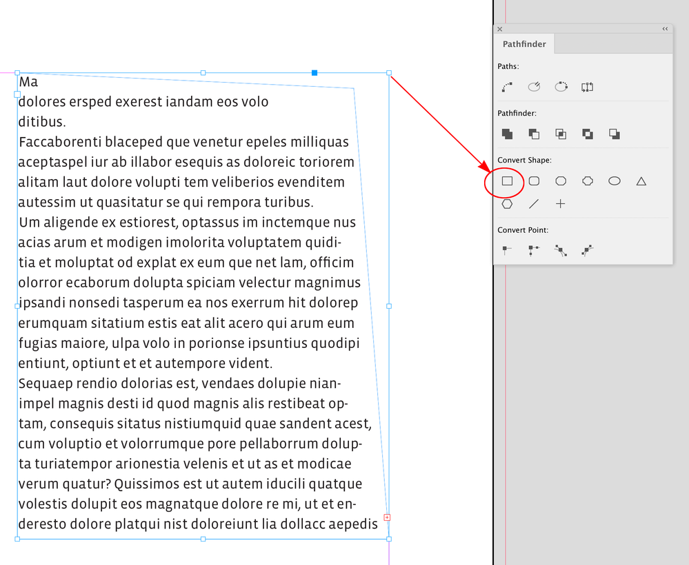

Hi @Ken Nielsen , If you have accidentally grabbed a text frame‘s corner point with the Direct Selection tool, you can set it back to square with Pathfinder > Convert Shape

You appear to have two text boxes overlapping.
It could be a text frame inside of another text frame as you suggest, but a text frame that has been changed into a polygon also shows two bounding boxes when it is Selected, which seems to be what @Ken Nielsen  is showing—can’t tell without seeing the entire frame?

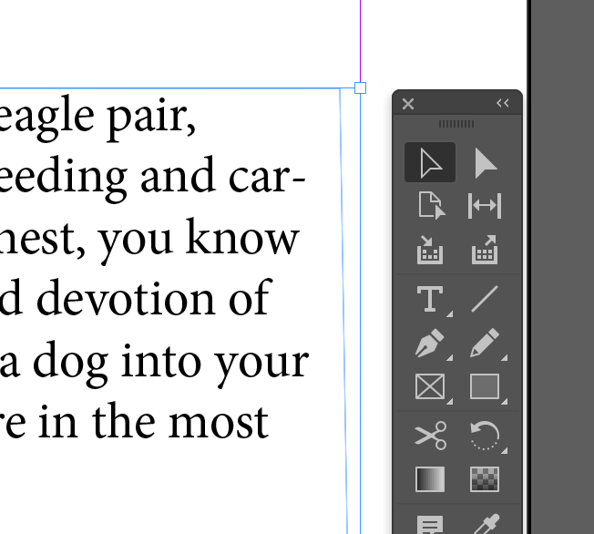

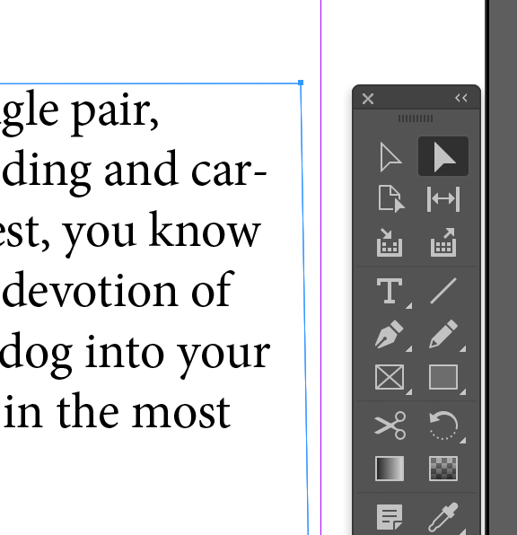

Yes Rob, this is what I have. When I select the full pointer and touch the frame it is one way and then when I select the lighter colored pointer it shows the frame a different way. You have shown what I have accidentally made. It is not two text frames or they could easily be separated and one deleted. It is not that but what you show here. How do I get out of it? What would you recommend for me to fix this?Screenshot 2024-01-10 at 12.57.05 PM.pngScreenshot 2024-01-10 at 12.56.56 PM.png

With the frame selected did you try Pathfinder Panel’s Convert Shape to rectangle button? See thw screen captures in my first reply.

Yes indeed. Object > Pathfinder > Convert Shape and then selected rectangle. I did not see the screen you show but that just shows how much, even after decades of use for InDesign since the day it was released, I still have tons to learn. Thank you Rob, with the text tool selected as I maneuvered to the Pathfinder menu and selecting the text block in question then choosing Convert shape and then selecting Rectangle it instantly popped back into a normal state. It looks like what I did by accident is kind of a form of 'text wrap' as the text behaves but the text block stays square and normal. Very good help and I appreciate.
