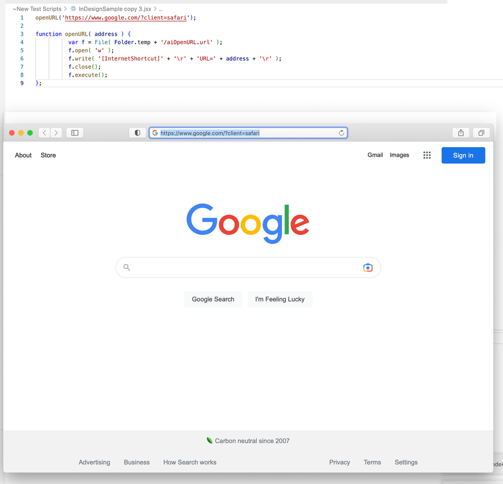

Searching the forum you can find examples like this (written by Muppet Mark):
// OpenBrowserWithJavascript.jsx
// siehe http://forums.adobe.com/message/4904789#4904789
openURL( 'www.google.com' );
function openURL( address ) {
          var f = File( Folder.temp + '/aiOpenURL.url' );
          f.open( 'w' );
          f.write( '[InternetShortcut]' + '\r' + 'URL=http://' + address + '\r' );
          f.close();
          f.execute();
Have fun
May 10, 2014 May 10, 2014
@pixxxel schubser – that code by Muppet Mark is working very well.
Thank you for sharing the link.
Leaves the question: Is it possible to determine a specific browser but the one the operating system is chosing?
On my Mac OSX 10.6.8 I'd like to open a particular URL not in Safari, but in Firefox.
Firefox seems to be my default browser, because if I saved a website to my file system and double click the *.html file I will always get Firefox (even if it's *not* already open).
With the script above executed Safari will open.
I did not find a control for that behavior in my OSX 10.6.8.
Uwe
@pixxxelschubser – thank you for that tip. But it didn't work as expected with Firefox.
I changed it back to Safari. And that was working quite well.
See what happened.
First I set file type url to open with Firefox with a text file renamed with *.url instead of *.txt. Clicked "Change All":
(Change should affect all files with file type url, not only that particular one)
Then I ran the code from ESTK. Firefox started (good!), but was showing the contents of the file (not so good!).
Firfox did not open the url contained by the file:
Uwe

Jan 04, 2023 Jan 04, 2023
Hi @Js1212 , Try this where the URL string is the complete address (include http: or https: as needed)
openURL('https://www.google.com/');
          f.open( 'w' );
          f.write( '[InternetShortcut]' + '\r' + 'URL=' + address + '\r' );
          f.close();
          f.execute();
Explorer ,
still getting the same error....attached is screengrab of code i ran....
did i insert the address in the correct place?
Worked for me. Does it work if you run from the Scripts panel?

LEGEND ,
You must pass a valid URL. Did you try with a valid URL? www.google.com is not a valid URL, even though you can type it in a browser.
Hi @Test Screen Name , The original code was assuming all addresses start with http://. In case it wasn’t obvious, I changed the write line from:
To:
so that a complete URL is needed and will work.

myBridgeTalk.send(10000); // If not supplied or 0, the message is sent asynchronously, and the function returns immediately without waiting for a result.
I used this as a reference for XMLHttpRequest.
https://github.com/AdobeDocs/uxp-indesign/blob/main/src/pages/reference/uxp-scripting-samples/UxpMod...
I don't know how to use fetch.
Please someone tell me.
https://developer.adobe.com/indesign/uxp/uxp/reference-js/Global%20Members/Data%20Transfers/fetch/
