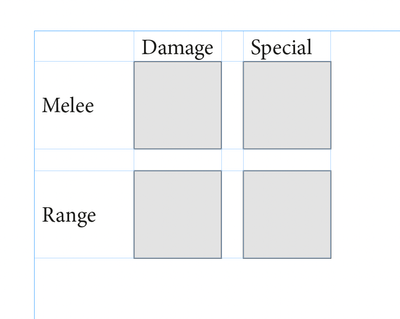

Try adding an extra row and column between the cells you want to have a border.
Copy link to clipboard
Copied
Ah, bordered cells — I missed that turn. No, ID doesn't mimic HTML/CSS table layout rules (such as allowing separated cells) so that could cause confusion.
Copied
You're probably correct that this is the best solution for achieving the desired visual. Sadly, it would have bad interactions with accessibility software, such as screen readers. A visually impaired person would need to listen to "Row 3 Cell 1: no data, Row 3 Cell 2: no data, Row 3 Cell 3: no data" etc.

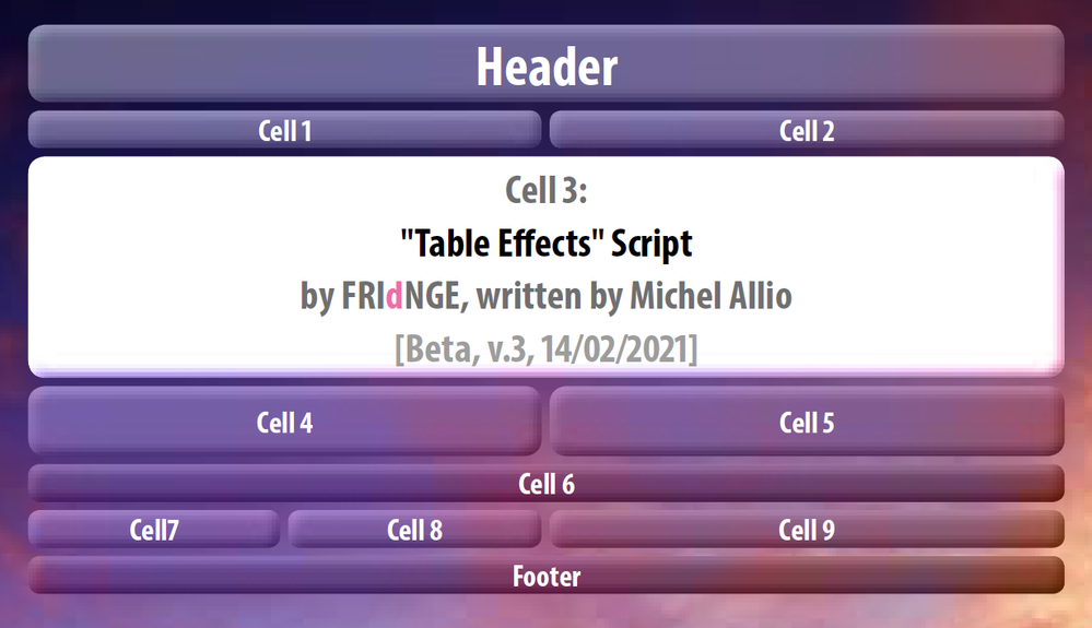

Maybe just a little too sophisticated but 1 table and 1 click! 😉
[paid script]
(^/) The Jedi
