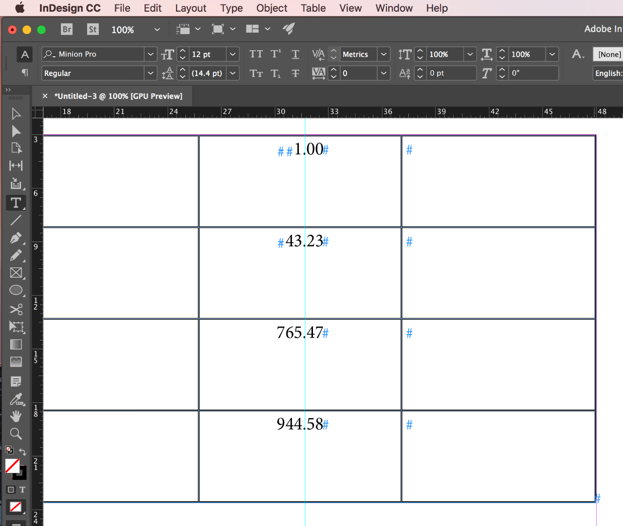

There's a workaround that is useful in limited situations—not too many instances, and you need to use font with monospaced figures.
Set the figures to align center with the column:

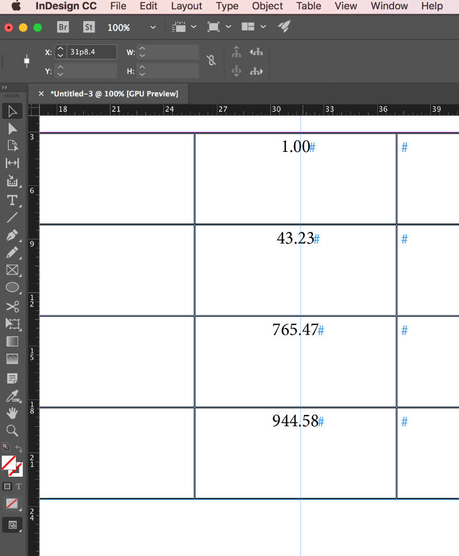

Use figure spaces in front of the short lines with Type > Insert White Space > Figure Space:

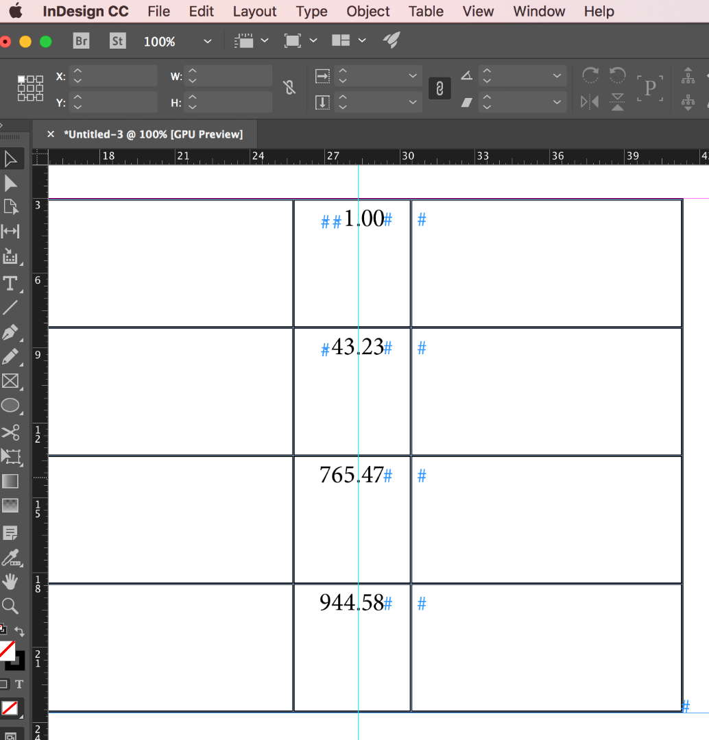

Now when you resize the column, the figures stay centered.
As I said, good to know but of limited usefulness. I deal with this situation more often than I'd like to. Sometimes using figures spaces is the answer, sometimes moving the tabs is the answer, but my preference is hold off on the alignment until we reach the end of edits. My editors can proof the numbers in advance, but they wait on proofing the alignment until I let them know that I've finalized it.
