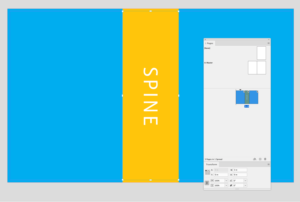

rob day
rob dayCommunity ExpertCorrect answer
August 5, 2022
Hi @Lynnette7 , Same question was just asked here:
https://community.adobe.com/t5/indesign-discussions/ability-to-change-page-size-moving-other-pages-in-spread-or/td-p/13116668
If you set your document up with facing pages checked, and create a 3 page spread, the pages will stay together when you adjust the center page with the Pages tool selected—then it’s just a matter of exporting the PDF with Export as Spreads checked.
Non Facing Page documents allow you to pull the pages apart, and the spread’s pages won’t necessarily stay together:

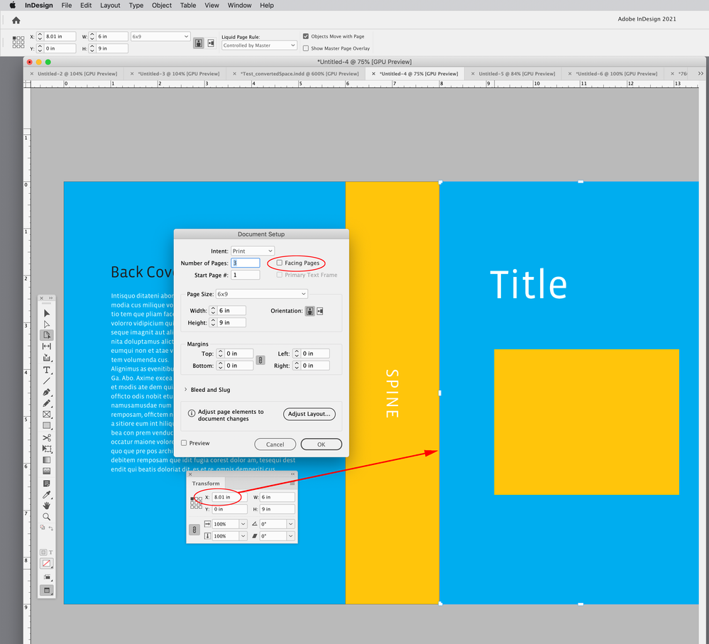

rob day
August 6, 2022
Or maybe something has changed since she made that tutorial and what used to be better, now isn't
Hi @Lynnette7 , Nothing has changed, I think she’s just missing the usage difference with Facing pages, which doesn’t allow a change in the X position. You can see that with the Transform panel—here Facing Pages is checked and X is grayed out—I can’t change the horizontal position of page 3:
With Facing Pages unchecked you can position up to 10 pages anywhere on the pasteboard. This would be useful in cases where the pages need to be trimmed on all 4 sides (e.g. a design for a tradeshow booth, or a wire-o bound book). A book jacket’s panels are folded, not trimmed.
