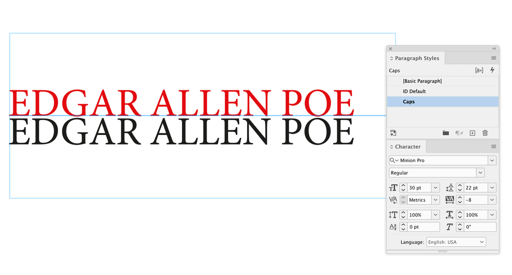

Why not make a Cap style with reverse tracking for the few fonts where it happens?
