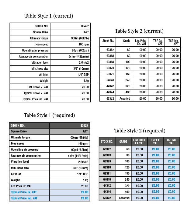

I have some very large documents with hundreds of tables, with two different table styles allocated (ie, some tables have "Table Style One" and some have "Table Style Two"). My issue is, whilst I have the two different table styles correctly assigned as required, I need to add much more complex cell styles to make them appear as I would like (see required look of tables attached at the bottom of this message).
Via Javascript/Extend Script, I would like to be able to 1) Target all tables in active document and clear Cell Style Overrides 2) 'Loop' through the active document and 'If' the table has "Table Style One" applied, then apply certain cell styles to the first row, second row, last row, second-to-last row and third-to-last row, 'Or' 'If' the table has "Table Style One" applied, the apply certain cell styles to the first row, the first column (excluding the first row), the last column (excluding the first row), the second-to-last column (excluding the first row) and third-to-last column (excluding the first row).
Here's where I am so far (it clears the cell style overrides ok, but that's all I've got so far, it's a work-in-progress!)...
Any help at all would be GREATLY appreciated.
Thanks
// This script assumes an Indesign Document is active (open), clears Cell Style Overrides in the active document, then if the table has a table style of "TableStyleOne", applies certain cells styles to its rows and columns, if the table has a table style of "TableStyleTwo", then it applies different cell styles to its rows and columns.

Explorer , Apr 01, 2019 Apr 01, 2019
Hi Manan,
Thanks so much again for the code you provided. I have had a look at it, and with the help of a colleague in IT (who, unlike me, actually knows Javascript!), we've come up with the code below. It can be adapted to add another function if someone wanted more than two tables (ie, they could copy the code for TableStyleTwo, paste it below, rename it and change the cell styles to match what they required).
It works like an absolute dream!
Cheers,
Dave.

Mar 28, 2019 Mar 28, 2019
Hi David,
Look at the following code, you can use the template given below to tweak it for your needs. This will iterate all the tables at the upper level not the embedded ones. One you get to the table you can check what is the table style applied over it and then also you can iterate over the rows, columns and cells of rows and columns

Explorer ,
Wow!, thanks Manan, that was quick! I will try and adapt that and let you know how it goes
