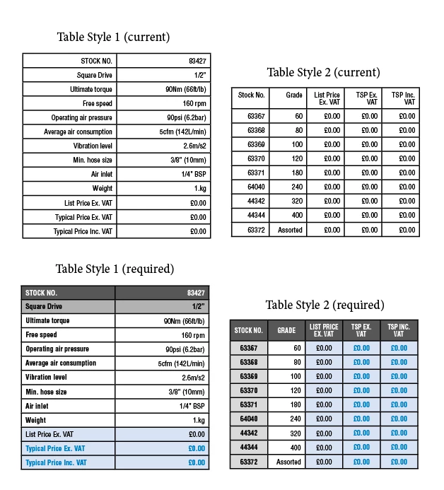

I have some very large documents with hundreds of tables, with two different table styles allocated (ie, some tables have "Table Style One" and some have "Table Style Two"). My issue is, whilst I have the two different table styles correctly assigned as required, I need to add much more complex cell styles to make them appear as I would like (see required look of tables attached at the bottom of this message).
Via Javascript/Extend Script, I would like to be able to 1) Target all tables in active document and clear Cell Style Overrides 2) 'Loop' through the active document and 'If' the table has "Table Style One" applied, then apply certain cell styles to the first row, second row, last row, second-to-last row and third-to-last row, 'Or' 'If' the table has "Table Style One" applied, the apply certain cell styles to the first row, the first column (excluding the first row), the last column (excluding the first row), the second-to-last column (excluding the first row) and third-to-last column (excluding the first row).
Here's where I am so far (it clears the cell style overrides ok, but that's all I've got so far, it's a work-in-progress!)...
Any help at all would be GREATLY appreciated.
Thanks

Correct answer davidh27380473
Hi Manan,
Thanks so much again for the code you provided. I have had a look at it, and with the help of a colleague in IT (who, unlike me, actually knows Javascript!), we've come up with the code below. It can be adapted to add another function if someone wanted more than two tables (ie, they could copy the code for TableStyleTwo, paste it below, rename it and change the cell styles to match what they required).
It works like an absolute dream!
Cheers,
Dave.
