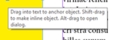

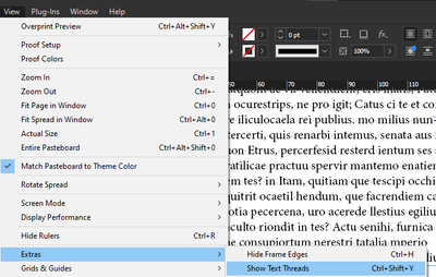

RvdT
Jun 26, 2024 1:46 PM UTC
View > Extras > Show Text Threads
Anchor image in text frame by (Shift+) dragging the small blue square to where you want the image to be linked to in the text frame.
You can also create an Object Style with Text Wrap if your image is not "inline".
Jul 2, 2024 10:02 AM UTC
Thank you for the screenshots so I can see exactly what to do. I am going to start on a test document to see how this works out for me. I appreciate your time so much!
