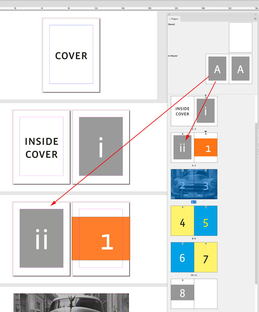

Hi Peter, A Master/Parent Spread can still have 2 pages when Facing Pages is turned off. I do it this way for an existing doc. See attached:
Allow Pages to Shuffle unchecked:
Turn off Facing pages
Split the desired spreads via the Pages Tool by Transforming X
Adjust bleeds
Apply the left page parent to page 4
Aug 08, 2023 Aug 08, 2023

I was just demonstrating how left and right master pages work as expected when Facing pages are turned off. If I had a job where the inside trim was visible, and needed a bleed, I would start with 2-page parent spreads showing the bleed, and facing pages off. As @Jason Burnett  points out not being able to view the spread is a problem when you are editing.
