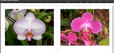

Hi, newbie here. Please would you mind letting me know if I have set bleed correctly - see first screenshot attached. I dragged the black background to the red line  Am I meant to drag it past that line though? And for the white page on the left, do I to drag the white background out to the red line too? On all my white pages, I don’t have any images sitting close to the page edge so not sure if I need to? I also attach the bleed settings in Document Setup. I set slug to zero as I don’t have any extra info for the printer. I hugely appreciate your help.

If nothing touches the edges of the page, you don't need to do anything:

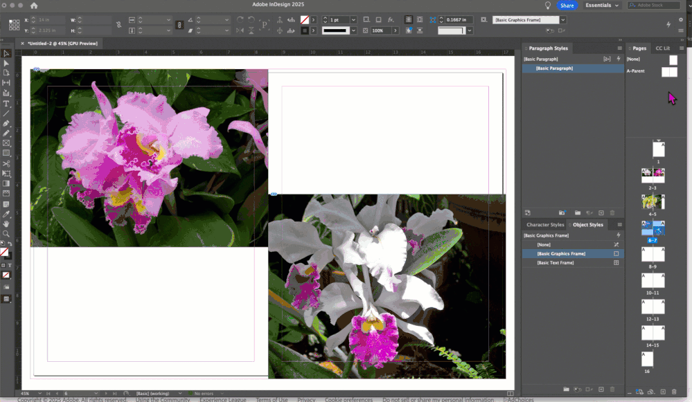

If a single image or background jumps the spread, you don't need to do anything:
If an image ends at the inside page edge--either on a single page or both pages (as shown here), you need to split the spread and adjust the inside bleed:
(I cheated and simply stretched the image out, but it should be enlarged and cropped.)
You do not have to put the spread back together.

Here is how to handle bleed on a magazine-type layout. This assumes you are supplying a print-quality PDF to the printer.

@Dave Creamer of IDEAS
My point about 16 pages was, that it most likely won't need inside bleed.
And instead of splitting pages to different spreads - pages can be just moved away from each other - so the document will look more "natural".

Black is OK.
Left - have you placed a Rectangle with the same size as the page? But there is no need - left page is OK.
Settings are OK as well.
How your document will be printed?
ali_4619Author
March 9, 2025
Thanks so much. I didn't put a rectangle on the left page. I'm getting it commercially printed, perfect bound - is that what you mean?
Robert at ID-Tasker
March 9, 2025
All great - as long as you'll have ONLY 16 pages.
If you'll have more - then you'll have to talk to the printing people about the inside bleed - if it's needed or not...
