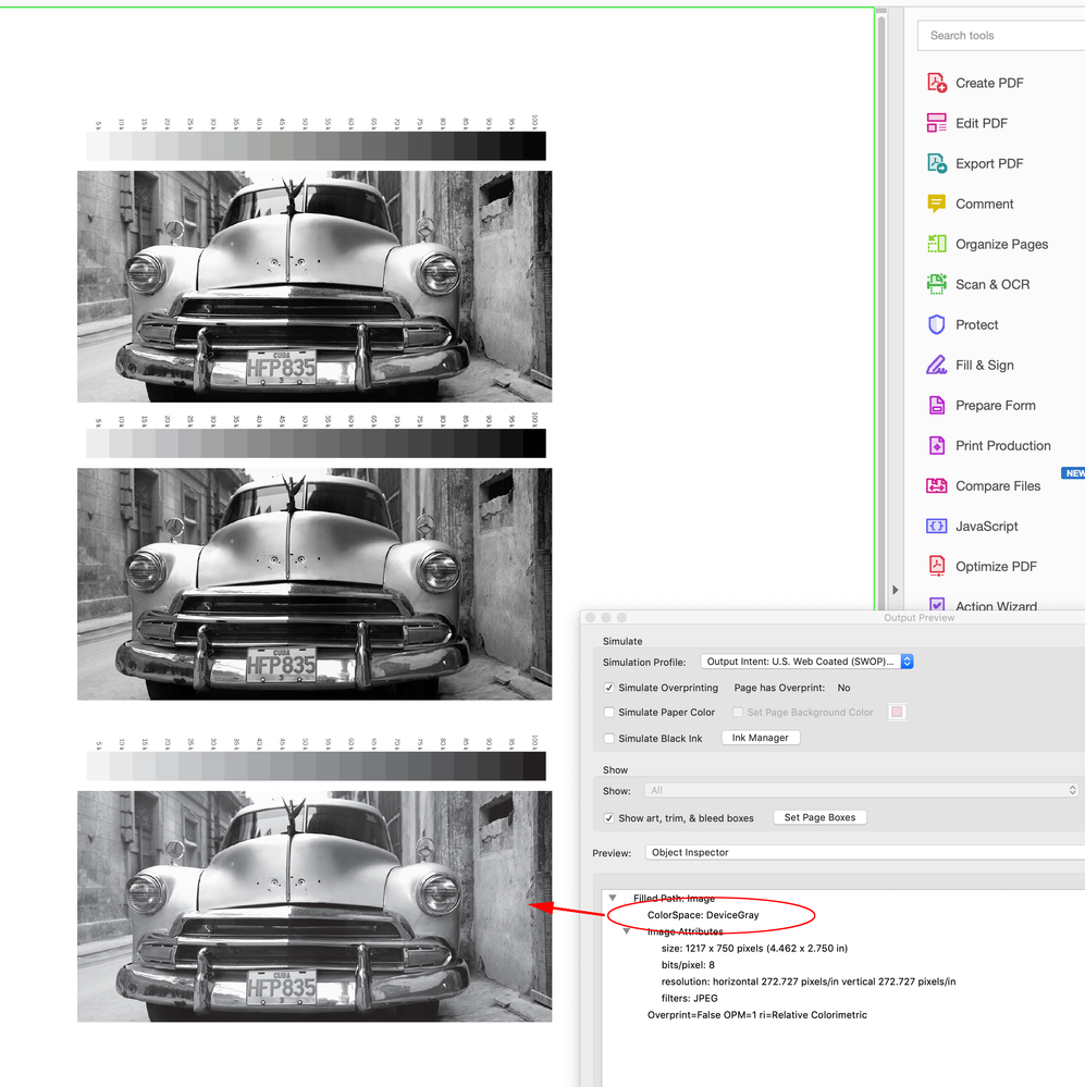

Just to clarify Uwe’s post, you can convert a placed flattened, grayscale image into a different color space inside of InDesign by direct selecting the image with the white selection tool, and apply an InDesign native color or swatch—the mode of the swatch determines the mode of the image in the exported PDF.
If you Export to the default PDF/X-4 preset with No Color Conversion, AcrobatPro will inspect the image color mode as the applied swatches’s space. The exception is—RGB or Lab black can’t be absolute black. So here I’ve placed the same grayscale 3 times, with the top version’s fill set to 1|0|0 RGB, the middle version is set to 40|35|35|100 CMYK rich black, and the bottom version set to 0|0|0|100 [Black].
AcrobatPro inspects the top image as profiled RGB using the document’s assigned RGB profile, the middle as DeviceCMYK, and the bottom image as DeviceGray:
If I check the 50% gray patch in Separations view, the top version is showing the color managed conversion of the ProPhoto RGB color into the US Web Coated SWOP Output Intent profile 50|42|42|5:
The middle version is showing a 50% tint of my 40|35|35|100 rich black CMYK swatch—20|18|18|50:
And the bottom version is showing the original 50% gray as 0|0|0|50:

I agree, but it is curious that the KDP recommendation is to provide flattened CMYK with no profiles (PDF/X-1a with no output intent!). The only cases where that works well is when the document CMYK values make it to press unchanged, and the press profile was known at Export.
https://kdp.amazon.com/en_US/help/topic/G201953020
It would be unusual for a composite printer to output document CMYK values unchanged—typically the driver handles the final output color conversions. A well constructed target proof would at least show what’s happening with the recommended DeviceCMYK/DeviceGray colors vs profiled RGB color. A DeviceCMYK color like 0|0|0|50 would have CMY in the output if the driver is making random color conversions.
The device variability could be exacerbated by their unprofiled CMYK recommendation, because each device would have to assume a document CMYK profile, which is not known.
