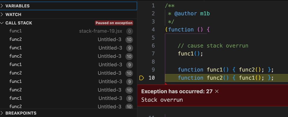

Hi @Marshall_Brooks
Aside: I'm actually shocked that the #includes in your switch code above actually work! It does work though—I tested it in simplified form. I always thought those directives were evaluated before the code is run, but your code proves this is not the case. 🤯
But here's my opinion. I strongly prefer to use included script files to load or instantiate objects, rather to perform actual operations. So my include files are like this:
/** @file MyWindows.js */
function MyWindowA(settings) {
    var w = new Window ( /* ... */ )
    // return the window closed value
    return w.show();
    function only_MyWindowA_Needs_Me () {
        // ... do something here that only MyWindowA needs
function MyWindowB(settings) {
    return w.show();
    function only_MyWindowB_Needs_Me () {
        // ... do something here that only MyWindowB needs
function i_Am_Used_By_Both_MyWindows() {
   // ... do something here that both MyWindows want
function populateListBox(listbox, data) {
   // ... example of a function used by both MyWindows
It defines a bunch of functions that I will then invoke in my actual script (or in other functions in other include files!). The thing is, if you run this script file, it will do nothing, because all it does is define functions.
Personally I think this is a much safer and cleaner approach to using multi-file scripts. Just my opinion.
- Mark

Hi @Marshall_Brooks
You *are* defining all your variables in the global space but it has nothing to do with ScriptUI. It is just what you are doing.
(It is also bad programming. I think maybe you don't know how to *not* define all your variables in the global space?)

@Marshall_Brooks I'm sorry to say that you are creating a horrible architecture. I strongly suggest you put your overall control code into the main script and include (at the start of the script—not using predicate logic) just library functions and objects.
As for the stack overrun, have a look in the debugger and see which function is filling the stack. For example I created a stack overrun by making a function call another function which then called the other function back...
- Mark
