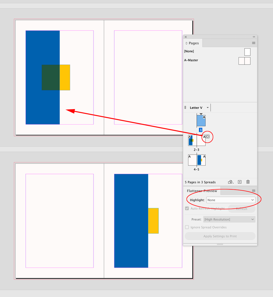

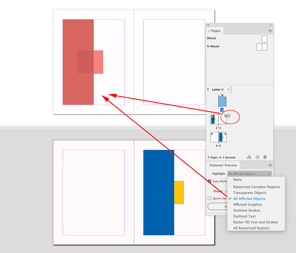

Hi @Snowdog63 , Also, not sure if this helps, but InDesign has the Flattener Preview panel which shows how a spread with any transparent object will be flattened for print using a selected Flattener Preset.
