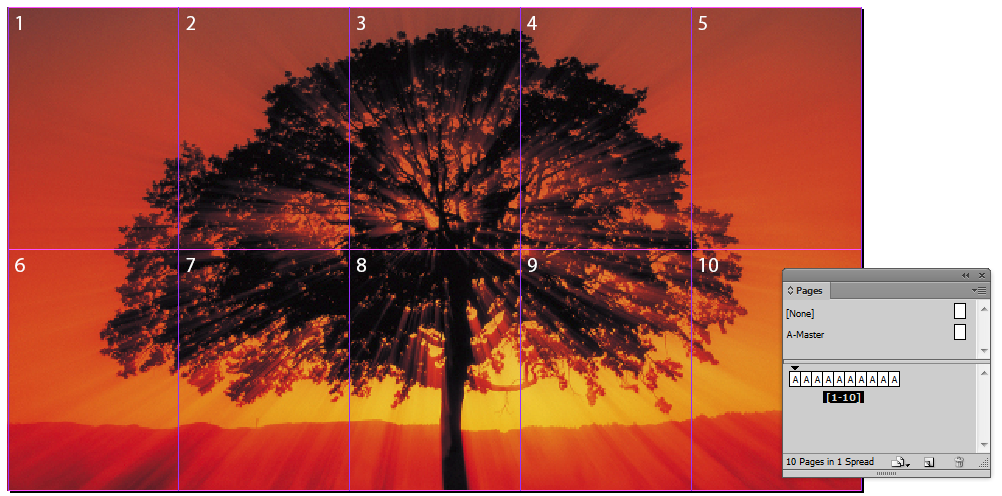

A short answer would be: nope, you can't. You're restricted to a single spread. However, spread can contain up to 10 pages. Here's how it may look in InDesign (don't allow spread to shuffle, and use Page tool to compose pages in spread):

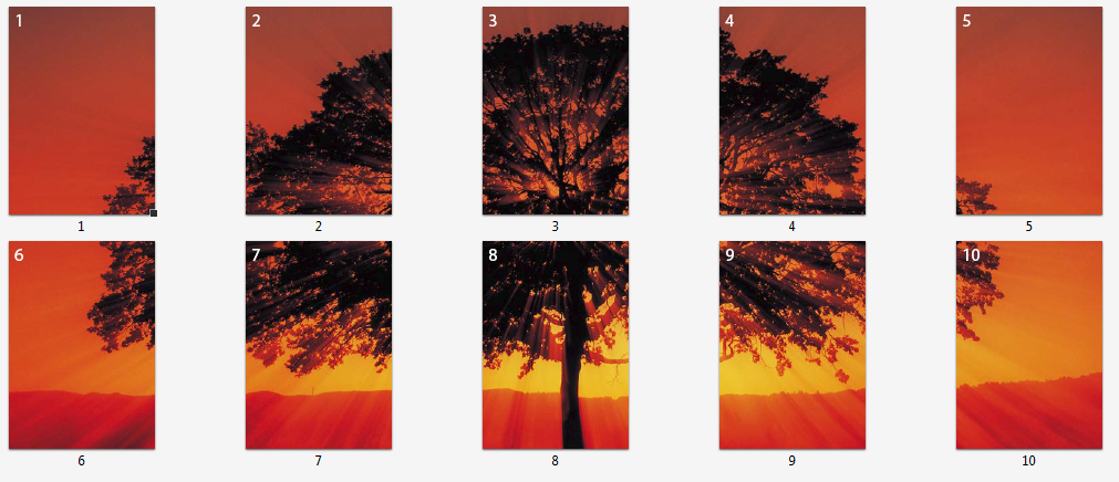

and exported pdf (thumbnails view):

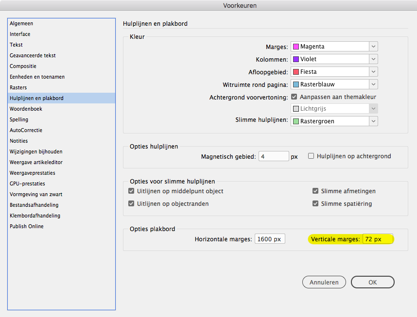

And you can make the gap much smaller under the Guides and Pasteboard section in the Preferences:
