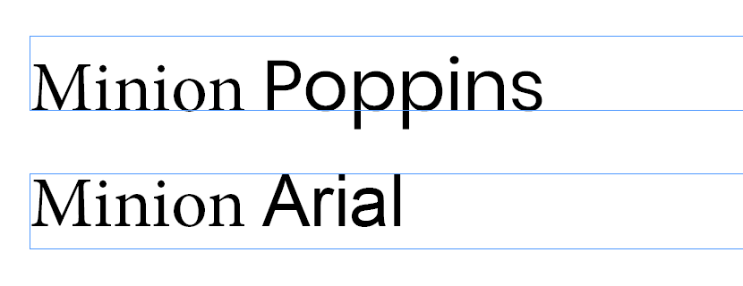

Different fonts may use different parameters even if they are the same point size...

Just to say, the problem (if it is a problem) is related to the font and its definitions:
Use of fonts that are compatible would be the best solution.
