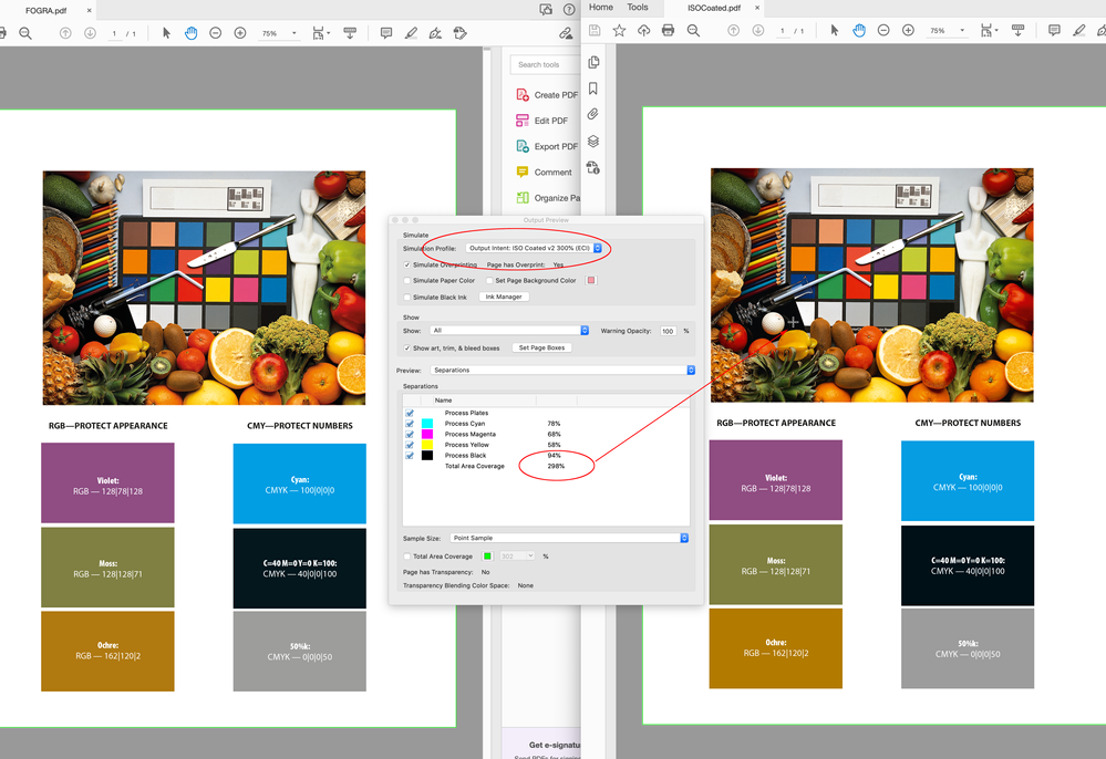

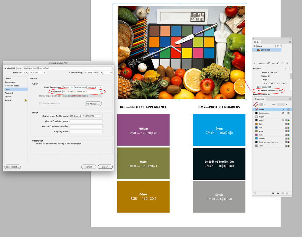

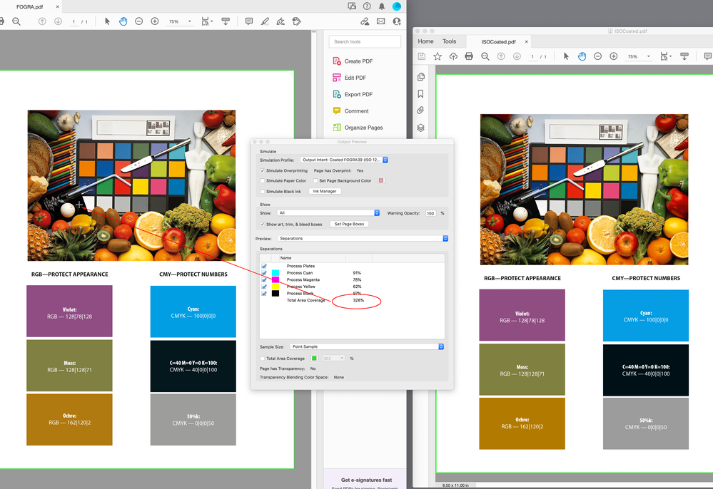

Sep 20, 2021 Sep 20, 2021

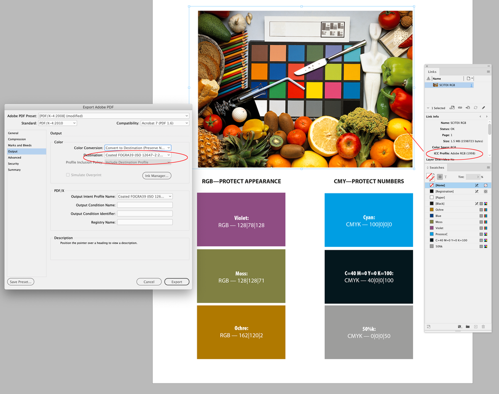

Here’s an example, my page has a placed RGB image with Adobe RGB embedded. On Export it will be converted into the chosen CMYK Destination space. I’ve also include some RGB colors where it is important to maintain the color appearance, and a few CMYK colors where I want to maintain the output values and don’t care as much about a change in appearance, for example 40|0|0|100 rich black or 50% black:
The export to Fogra PDF/X-4 with FOGRA set as the Destination and preserving the CMYK swatch numbers:

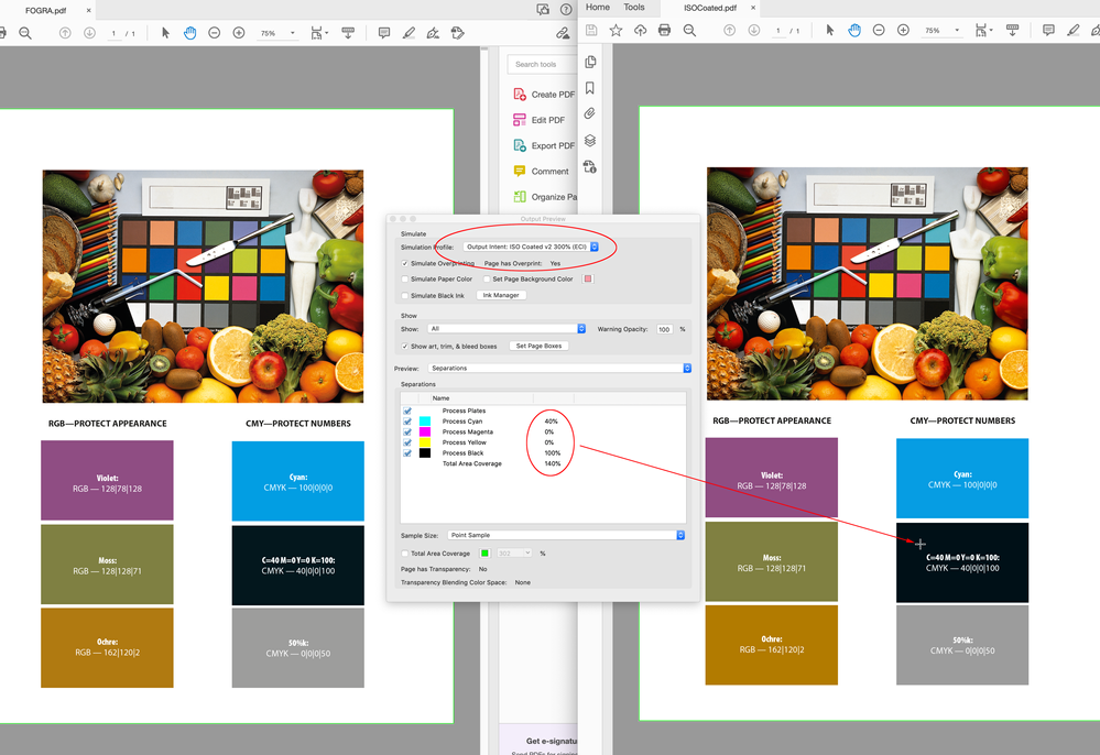

Then an Export to ISO Coated:
In the PDFs the RGB swatches converted to the chosen destination CMYK spaces, maintaining their appearance, but with different output CMYK values.
The black point in the Fogra PDF has a total ink coverage of 328%:
The black point in the ISO Coated PDF has a total ink of 298%, which happens on the conversion to ISO Coated:
The RGB swatches are converted to the correct (but different) CMYK values in both cases, but the CMYK swatch output values are protected:

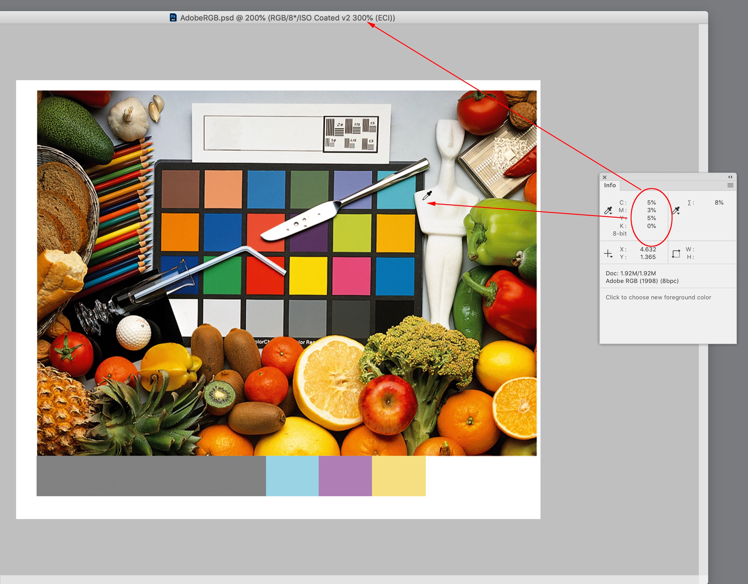

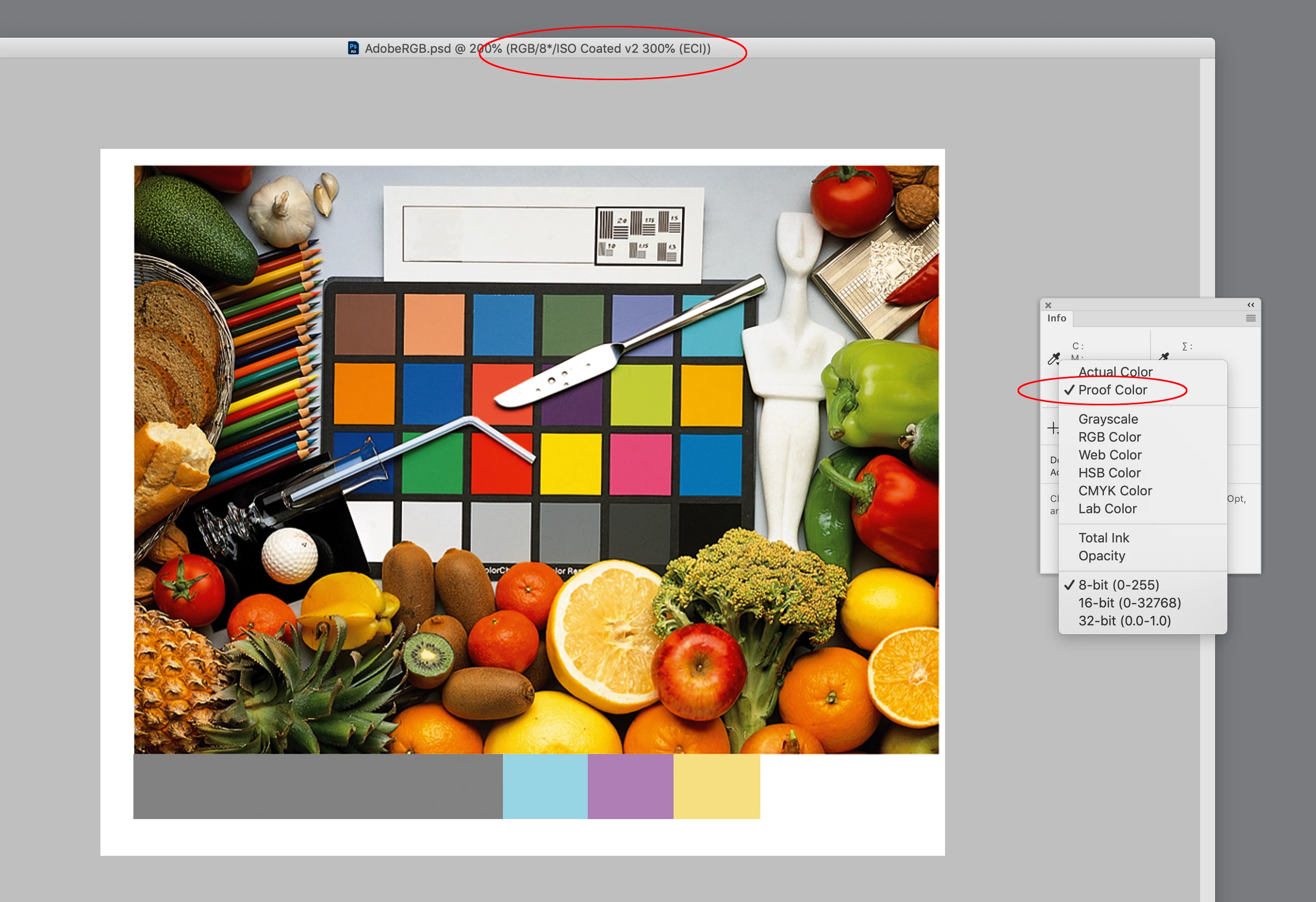

Sep 21, 2021 Sep 21, 2021
If you wanted the edited CMYK color to output unchanged to both PDFs, your only option would be to save the CMYK images with no profile, and try to prevent them from being color managed. That might not be a problem when the output is to very similar coated profiles like FOGRA and ISO, but the color appearance differences would be more noticable if the profiles were less similar, something like a coated vs. uncoated profile.  Also, you can’t really control the final output CMYK values—you have no way of knowing if the the magazines are letting the PDF’s CMYK values output unchanged. There could easily be additional Device link or CMYK-to-CMYK conversions happening at output.
The better approach might be to edit in RGB mode with Photoshop’s Proof Setup set to CMYK, Proof Colors turned on, and the set your Info dropper to Proof Color. In this case I’m editing the proof destination output numbers without actually making the conversion.

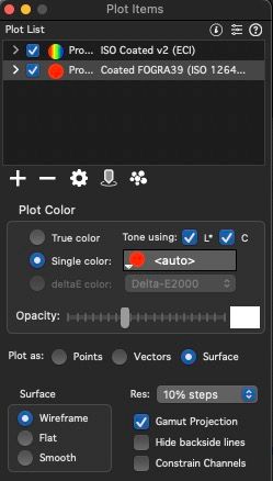

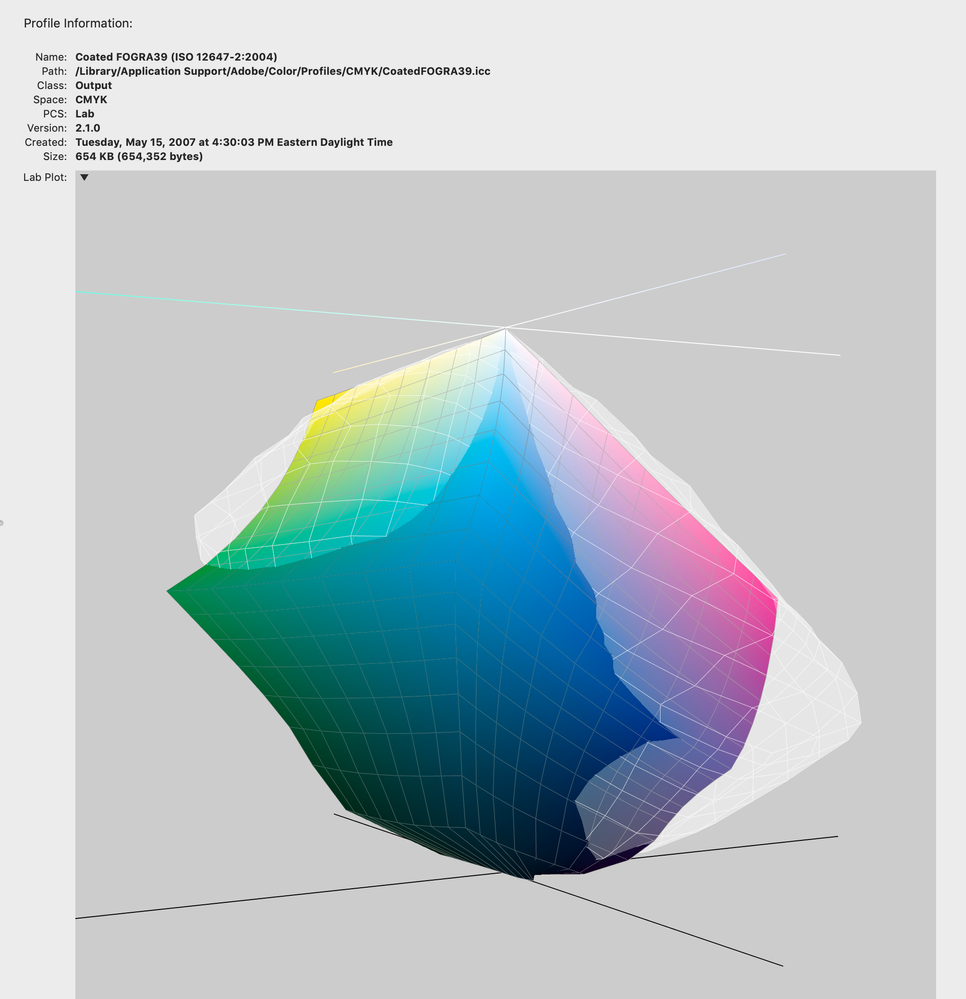

Hi Neil, Not sure I can help, but I think there is a big enough difference in the two CMYK profile gamuts, that the ideal would be to convert directly from a large gamut RGB space to the final print CMYK space (not RGB>CMYK>CMYK).
When I compare Coated FOGRA39 to ISO Coated v2 300% with Apple’s ColorSync Utility, I can see that Coated FOGRA39 has a larger gamut in the blues. Here is the comparison (ISO Coated v2 300% in white):

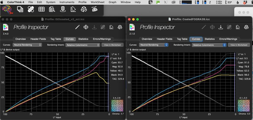

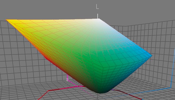

Hi Rob,
thanks for pitching in
This job would be ISOcoated_v2_eci.icc, not the 300TAC inklimited version. [ISOcoated_v2_300_eci.icc]
They ALMOST sit right atop (within) each other in Colorthink 4, where any difference seems to possibly be plotting errors - I'd hope CT4 is showing this accurately - how did you plot please?
almost zero difference is indicated. which would be great if that’s accurate - as they are said to be interchangeable - or how so we have standardisation? I wish Adobe had simply adopted ISOcoated_v2_eci.icc
there ARE some differences in the ink curves for sure
