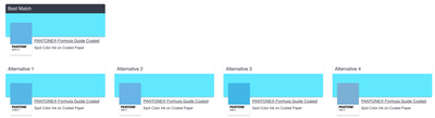

You'd need to take you CMYK values
 Input the CMYK values here
https://www.pantone.com/eu/en/color-finder 
Which actually gives you various Hues of the colour
Which gives you results like this
As you can see there are vast differences in the shades.
