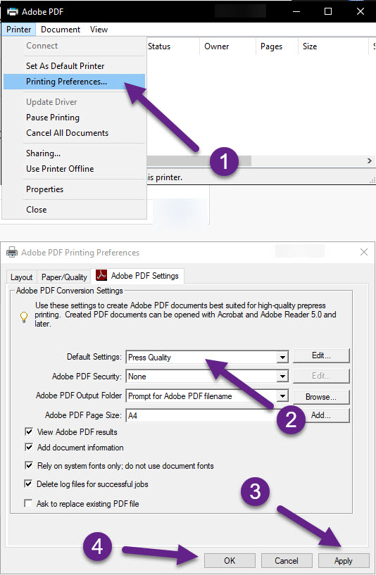

Hello all,
When I print to PDF using InDesign CS6, it only prints using the "standard" job definition file in Acrobat. Absolutely nothing I do will save my preference as "Press quality" instead. Can this be done?
I've switched to using Export instead of Print and can easily select press quality there, but honestly, I'd rather just use the print dialog instead. Is this possible, and if so how?
Thanks in advance.
