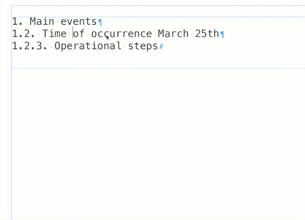

To simply match the numbers at the beginning of a paragraph to replace with something else here is one example. I suspect there are more efficient queries but I seem to be the only one here for the moment.
 ^(\d+)\.(\d+)?\.?(\d+)?\.?
~Barb

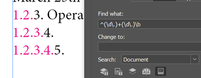

We can use what we were talking about recently - when you were unsure about the difference between
\> and \b
Here's a perfect case to find these things - and you don't need a Change To
I went one step further - but if it's not what you need we can cut it back but it's just an example and proof of concept.
^(\d\.)+(\d\.)\b
To highlight what's being found - I put in pink for show and tell
With nothing in Change To and hit change all
Again - it's just a demonstration.
