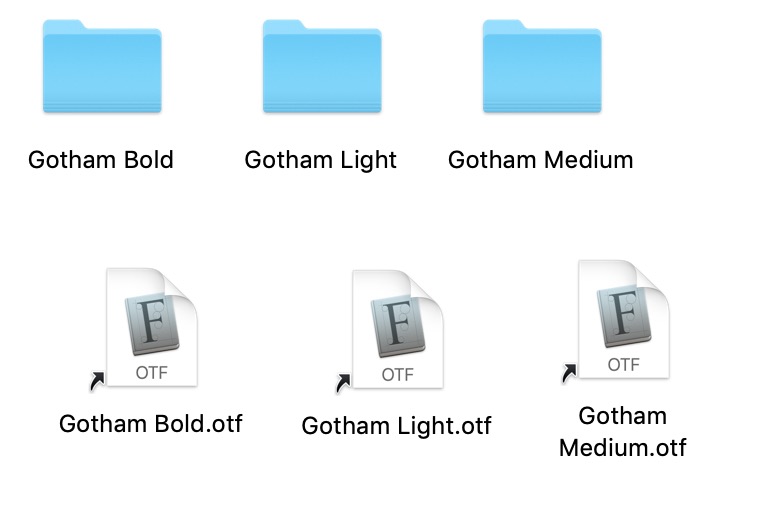

Get the files out of those individual folders.

They are out but I still get the message they are not there. See screenshot of message and them out of the folders.Screen Shot 2019-02-28 at 8.30.14 PM.jpg
Feb 28, 2019 Feb 28, 2019
Those look like aliases, not the files themselves.
Bob is correct. You didn't really get the files. Those are aliases.
But they're also the wrong fonts. If you look at your list of missing fonts it shows "Gotham (T1) Medium", "Gotham (T1) Bold", and "Gotham (T1) Light". The T1 means Type 1.
But the aliases are pointing to OpenType fonts (GothamBold.otf, GothamLight.otf, and GothamMedium.otf.
They aren't the same font type as what the file is looking for.

Yes, when I pull them out they are aliases, Bob.
So Steve, I don't even have the correct type of files?
So, I guess I will need to buy the font then. Since these are incorrect.

Did you drag them out or cut/paste?
If the former, that could just create an alias. So cut/paste them from the folders.
