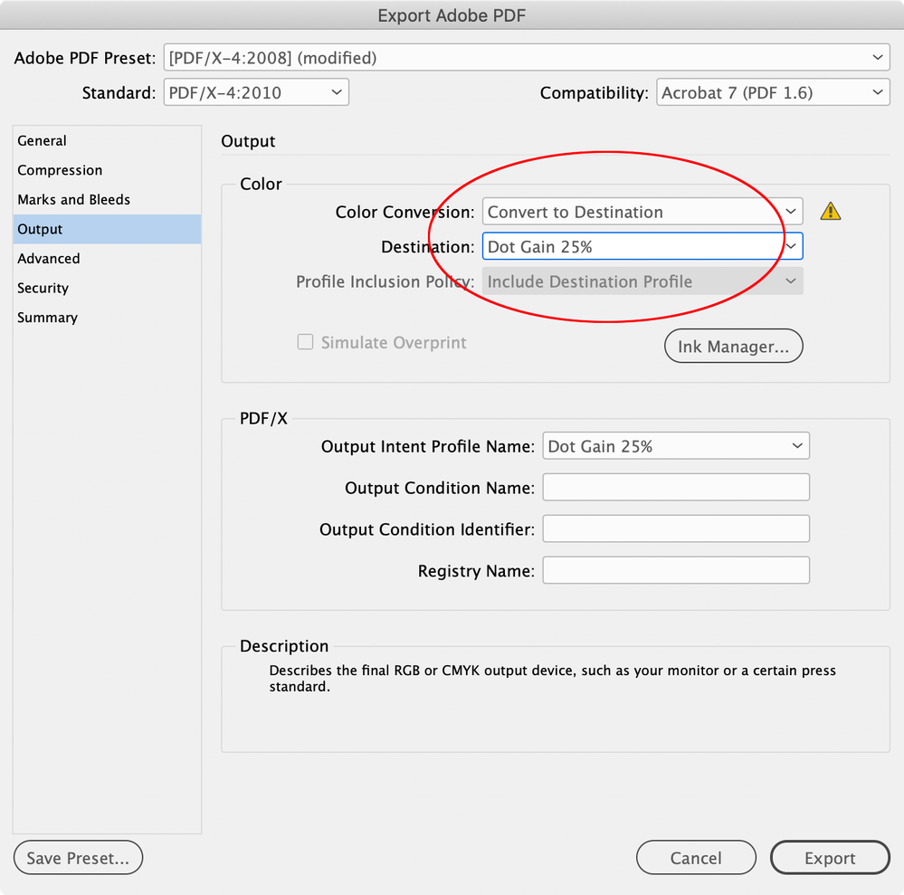

Hi @PjMcCabe , The original post is from 2010, see @Peter Spier ’s answer from 2015. You can convert directly to any Grayscale destination by choosing a Gray profile from Output>Destination when Convert to Destination is chosen as the Color Conversion:

I'm Not getting the 'Dot Gain 25%' option as a drop down. I have followed threads about removing colour settings (the ACEConfigCache2.lst) - tried that and no change.Screenshot 2023-06-04 at 11.56.55 AM.png
Updated versions of Mac OS and CC.
Jun 03, 2023 Jun 03, 2023
Set "Color Conversion" to "Convert to Destination." You will then find the Dot Gain options in the list for "Destination":
There are many subtleties to doing color conversion in PDF export, but I will just add that, for things like KDP printing and most color-source to B&W printing, the SGray option (currently at the very bottom of the list) has done an excellent job with very little fussing.

Those options are not there - that's the problem. This is the screenshot I meant to do...

Hi @agrm , That would happen if you have your Color Settings set to CMS Off—with color management turned off the only Destination color spaces available are Document RGB and CMYK. Make sure your Color Settings are not set to this:
Explorer ,
Jul 13, 2023 Jul 13, 2023
It looks like your Standard Drop down menu near the top is set to none. It should be PDF/X-4:2010 and will give you more results. 🙂
