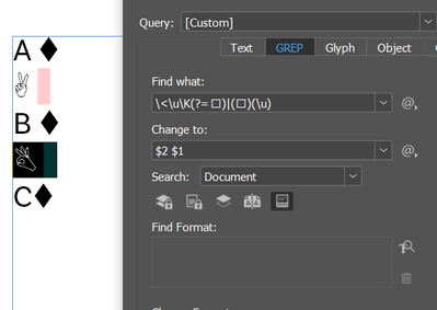

Contributor ,
May 04, 2024 May 04, 2024
When I do this grep search it works
\<\u\K(?=)|()(\u)
But it changes the font ---
Never noticed it did that before
Thought it only swapped 2 with 1
Odd.
LEGEND ,
@Eugene Tyson
Because when you change found result - InDesign is changing text contents - so any "extra" formatting is lost.
That's why I've suggested look ahead / behind - or simply replacing this glyph with some unique text.
Yeh was just looking at doing both at the same time
But you can't.
I even applied character styles to the letters and it swaps the character styles.
That seems like very unwanted buggy behaviour.
