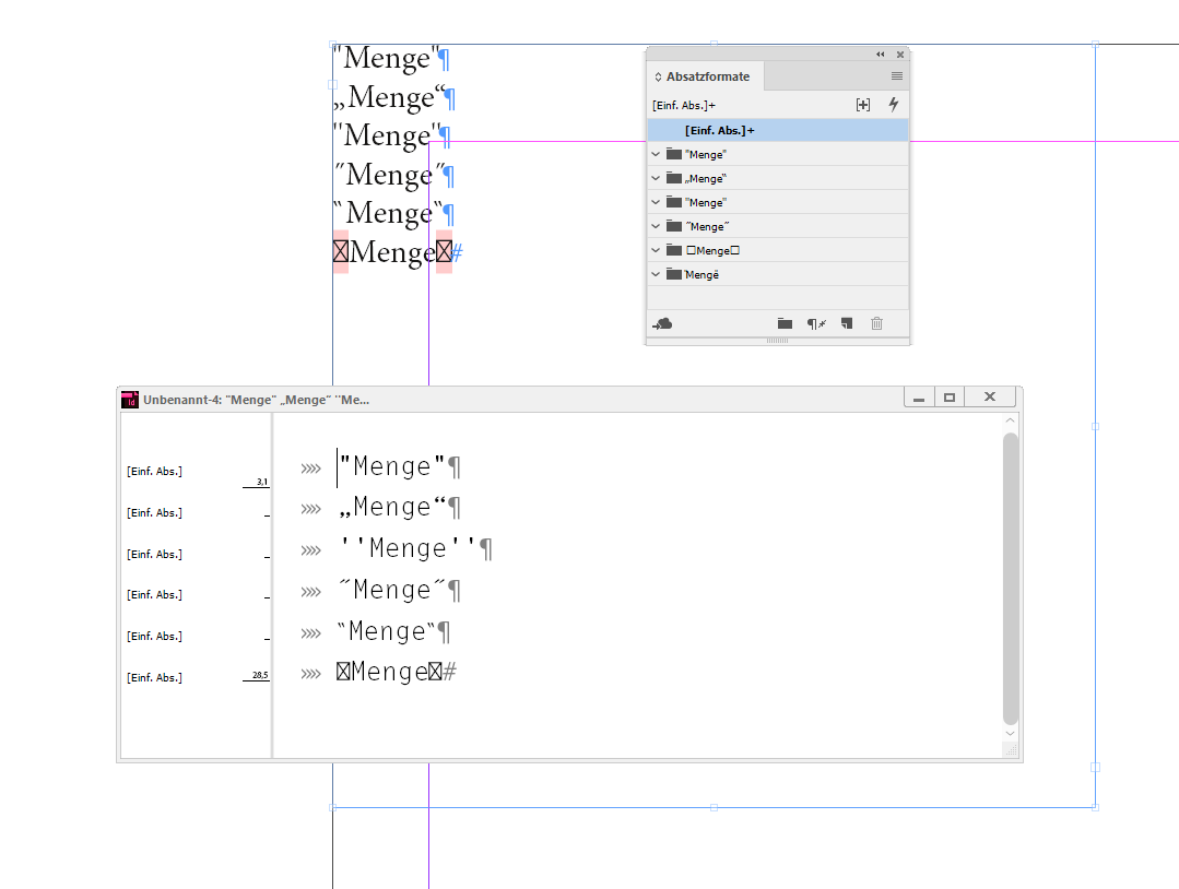

Run the following code that will add a new text frame to the first page of your document.
The contents of the frame are all names for all style groups in the root of your paragraph styles panel.
The language for the text is set to "No Language".
var doc = app.documents[0];
var newTextFrame = doc.pages[0].textFrames.add
        geometricBounds : [0,0,100,100] ,
        parentStory : { appliedLanguage : doc.languages[0] } ,
        contents : doc.paragraphStyleGroups.everyItem().name.join("\r")
After that inspect the glyphs that make the quotes.
Here a sample screenshot from the result I did with a document that uses some strange kind of quotes in the names:
As you can see from my Story Editor Window and compare this with the look of the names in my paragraph styles panel some look similar enough, but in fact are not. Otherwise I could not have created the style group.
The third and the first one listed look quite the same.
But apparently they are not!
Test my code snippet and come back if you found the right unicode value(s) for the two quotes.
FWIW: Both quotation marks could be different and could be composed of one or two glyphs.
If so list the unicode values for every single glyph surrounding Menge.
Uwe
EDIT: Removed one line of the code that was not necessary.
cmoke73Author
August 8, 2019
Hi Laubender.
Many thanks for your effort! Your detailed explanation is very helpful as well.
A little remark: the name is not the name of a group but for a paragraph-style IN a group. But it doesn´t really make a difference.
The Unicode for the opening quote is 0x201E and for the closing one it is 0x201C.
