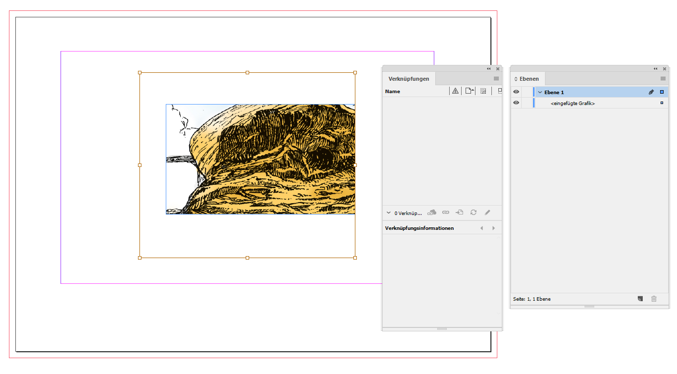

Hi cmoke73 ,
there could be graphics in the document where no itemLink is there.
Pixels perhaps that are pasted from e.g. PhotoShop.
Screenshot from my German InDesign:
"Ebenen" means "Layers"
"Ebene 1" means "Layer 1"
"<eingefügte Grafik>" means "<pasted Graphic>"
"Verknüpfungen" means "Links"
In the sample document shown above there is one pasted bunch of pixels from PhotoShop.
allGraphics array length is 1.
app.documents[0].allGraphics[0].itemLink ; // Returns null

Hi cmoke73 ,
app.documents[0].allGraphics[0].itemLink.filePath ; // Throws an error: Null is not an object
So always check, if itemLink == null before going on with any property of itemLink.
Uwe
