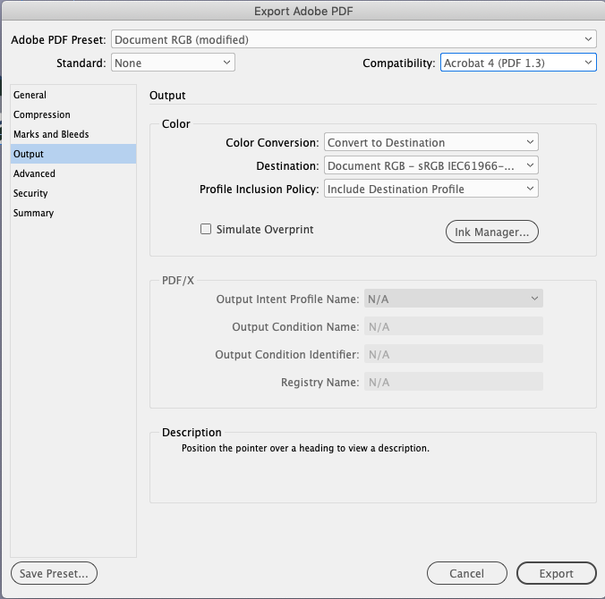

Composite print drivers don’t always handle transparency flattening and CMYK color conversions correctly. Try exporting a flattened PDF to document RGB, Something like this:
If you still have the problem printing from Acobat try checking Print As Image from the Print>Advanced tab.

Thanks for the suggestions @rob day.  I tried them both .  The second method (Print>Advanced>Print as BMP>600dpi) worked great - the green box was not visible.  When I tried the first method (PDF conversion) and then printed the resulting PDF, the green box was still there.  But if I used the Acrobat print dialog to select Advanced>Print As Image>600dpi, the box was gone.  So it seems that the issue has something to do with how HP interprets the print data sent by Adobe, a problem that is resolved if Adobe sends the entire page as a single image.
The workaround to print-as-image is fine for me, but the challenge is that I will be sending PDF versions of this InDesign file to other people, many of whom will be printing on HP printers.  I don't want their printout to have the green box, but I can't really include printing instructions with my file.  Any thoughts on how I can create a PDF that will print clean without selecting print-as-image in Acrobat?

You might be able to force the page to rasters on a flattened Export (Acrobat 4) by creating a Flattener Preset like this, and using it in the Export Advanced tab:
