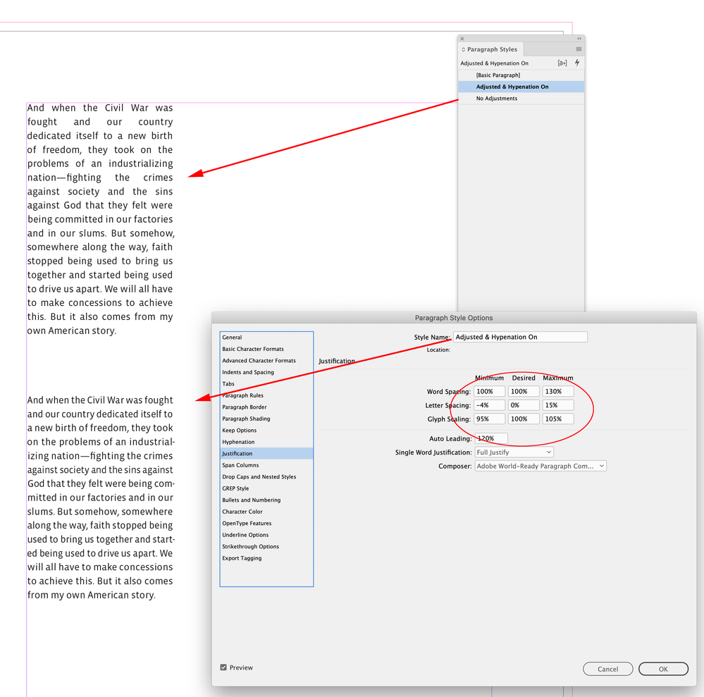

Hi @turner111 ,  To avoid violations, I think you also have to consider the measure width, and whether you are willing to turn on hyphenation, and allow Spacing and Scaling adjustments.
Here the top paragraph has hyphenation turned off and isn’t allowing any Word or Letter Spacing, or Glyph Scaling adjustments. With these settings all the justified lines will show violations because it is impossible to fully justify text without some kind of adjustment (violation):
The problem with not allowing any adjustments becomes more obvious with a narrow measure—the top paragraph with no adjustment allowance has rivers of white space:
I can make an additional adjustment to the Desired Letter and Word spacing to get a looser setting without the rivers of white space:
