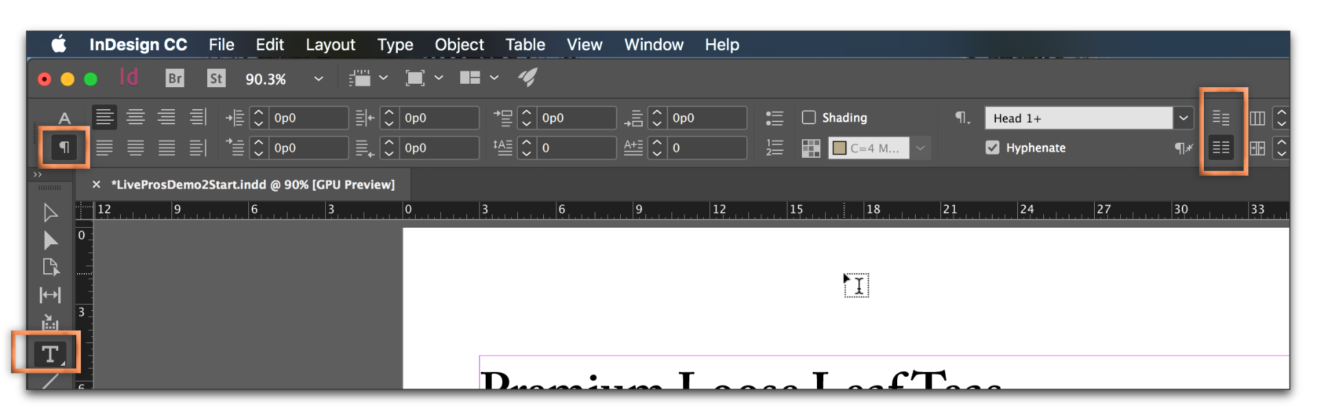

Hi Karen: you will want to keep this in mind:
Now, recognize that when you align everything to the grid, when something doesn't fit (i.e., heads set at 16pt leading) they are going to hop down to the next grid line. You can live with that, or take heads off the grid.
Either everything (body and heads) are on the grid, or you leave the body on the grid and take the heads off the grid. To take them off the grid, select one of the heads with the Selection tool, switch to the ¶ view of the Control Panel, and click the Do Not Align to Baseline Grid button. Then redefine your style so that all the heads follow suit. Or if you aren't using styles, repeat for each heading.
