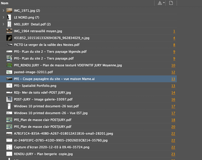

Hi @Emmanuelle15C2
Can you show your Links panel so we can see your assets and that they are properly linked? The Save As should have done it. Resize the panel taller and wider so we can see all of it.
And sorry, I meant before the Save As and after the Save As. As @jmlevy , it should have been more dramatic with all the deleting you did.
Saving as .idml might work, then resave as .indd, but don't do that yet. There may be an issue with your links.

Community Beginner ,
May 04, 2021 May 04, 2021
Copy link to clipboard
Copied
    Here is the link panel
