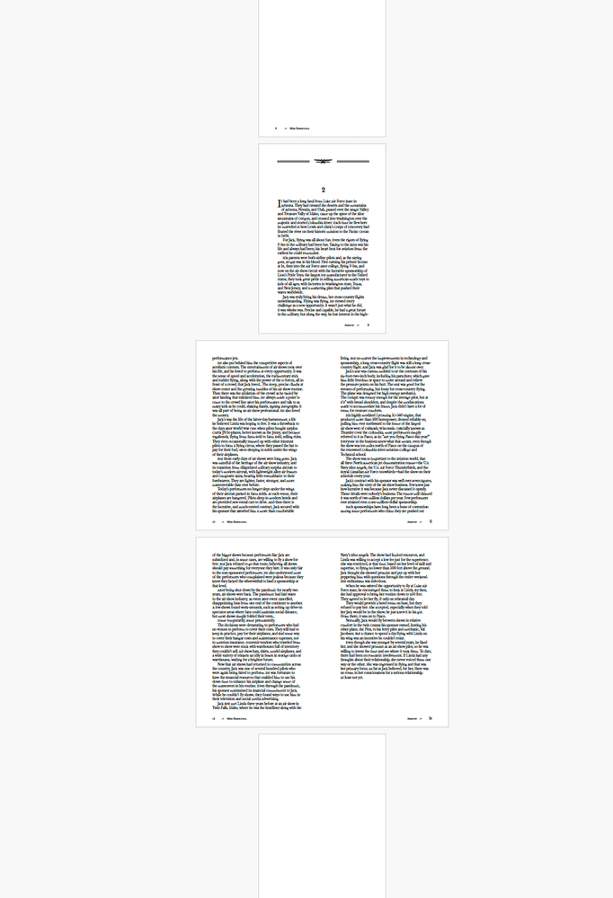

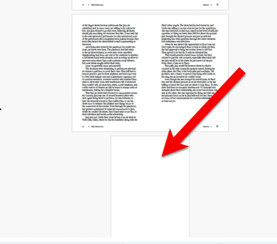

Hello, I can't figure out what I am doing wrong with the spreads in this book. When converted to PDF the pages seem separeted at chapters. (see screen shot).
I've added pages, deleted pages, trying to get the book (when in PDF format) to flow properly.

@Dave Creamer of IDEAS  that's the layout you would see in Acrobat when exporting as spreads from the Book panel...
I think those cases where there are two two-page spreads displayed together are problably a case of choosinfg to display 2-up.
@Lisa Dorn Design You should export this from the Book panel as single pages and set the view to 2-up, cover page and your clinet should see what you want. Unless there are marks or bleeds you don't want the clent to see, you can even use the same PDF you w

One of the inherent problems of exporting PDF from a .indb book project is that the spreads do not combine across document boundaries.
The only way I can think of to make exported spreads that "look" correct is to move pages from one doc to another so that every file ends on an odd-numbered page.
BUT, as a matter of principle I would recommend against exporting as spreads and let the user decide how rthey want to view the PDF. You can set the PDF up to display as two-up with cover page as the default initial view.

It looks like your documents are using a combination of Facing Pages and single pages placed side-by-side.
What are your book's pagination settings?

How did you get this layout in Acrobat:
This is the typical two-page spread with cover layout:
Oct 09, 2025 Oct 09, 2025
@Lisa Dorn Design You should export this from the Book panel as single pages and set the view to 2-up, cover page and your clinet should see what you want. Unless there are marks or bleeds you don't want the clent to see, you can even use the same PDF you will send to the printer.
@Peter Spier Yes, I suspected spreads since I did not see a center page line in the PDF screen captures. Just wanted to confirm.
@Lisa Dorn Design As Peter stated, export as single pages. Spreads can't match up a left-hand page from one document to the right-hand page from the following document (and vice versa).
