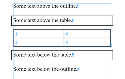

How do I prevent border formatting from disappearing whenever I insert a table?
Contributor ,
Nov 05, 2022 Nov 05, 2022
Hopefully the image above tells you all you need to know, but this is the inside of a textbox. I swapped out the genuine text with placeholder text so as not to distract you, but otherwise this is a very real project I'm actually working on.
So the text above appears inside a border. The text below appears inside a border. But what I actually want... I generated my desired output using photoshop, but I don't know how to replicate it into anything sensible in inDesign.
(I'll be changing the colour of the cells later anyway, so it doesn't matter if the solution preserves the transparency inside the cells or not.)
So, how do I do this?

It's hard to know what is going on without a detailed screen shot. Please provide one with frame edges and hidden characters showing. The box around the text above and below your table (which I assume you want gone) could be strokes on frames, paragraph borders, or tables.
Contributor ,
Better?
Yeah, those are paragraph borders
Edit: If it helps to know, this is the top of 16 linked textboxes. So there is some wordwrap from the previous textbox.

Would just adding a stroke to the text frame solve the problem? Unfortunately there doesn’t seem to be a way to apply a paragraph border to a paragraph with a table in it. Below you can see five paragraphs, including the one with the table. The paragraph border is not applied to the paragraph with the table in it, despite all thee middle paragraphs having the same formatting.
