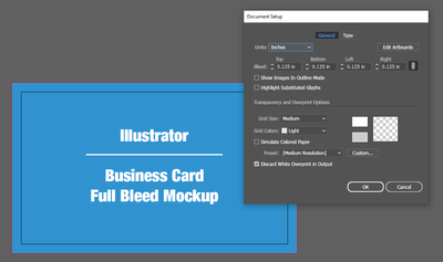

I am the graphic designer for my print company. I am trying to automate some processes and we produce a lot of full bleed print products. An issue I have encountered between InDesign and Illustrator is that it seems they have two different sized crop marks. I have all of my export settings the same, however when I export the files from each of the programs, the finished file size is different. Yes the trim size is correct for both, however it becomes an issue when creating n-up print templates. Any suggestions to help correct this?
Illustrator Document Setup Settings:
