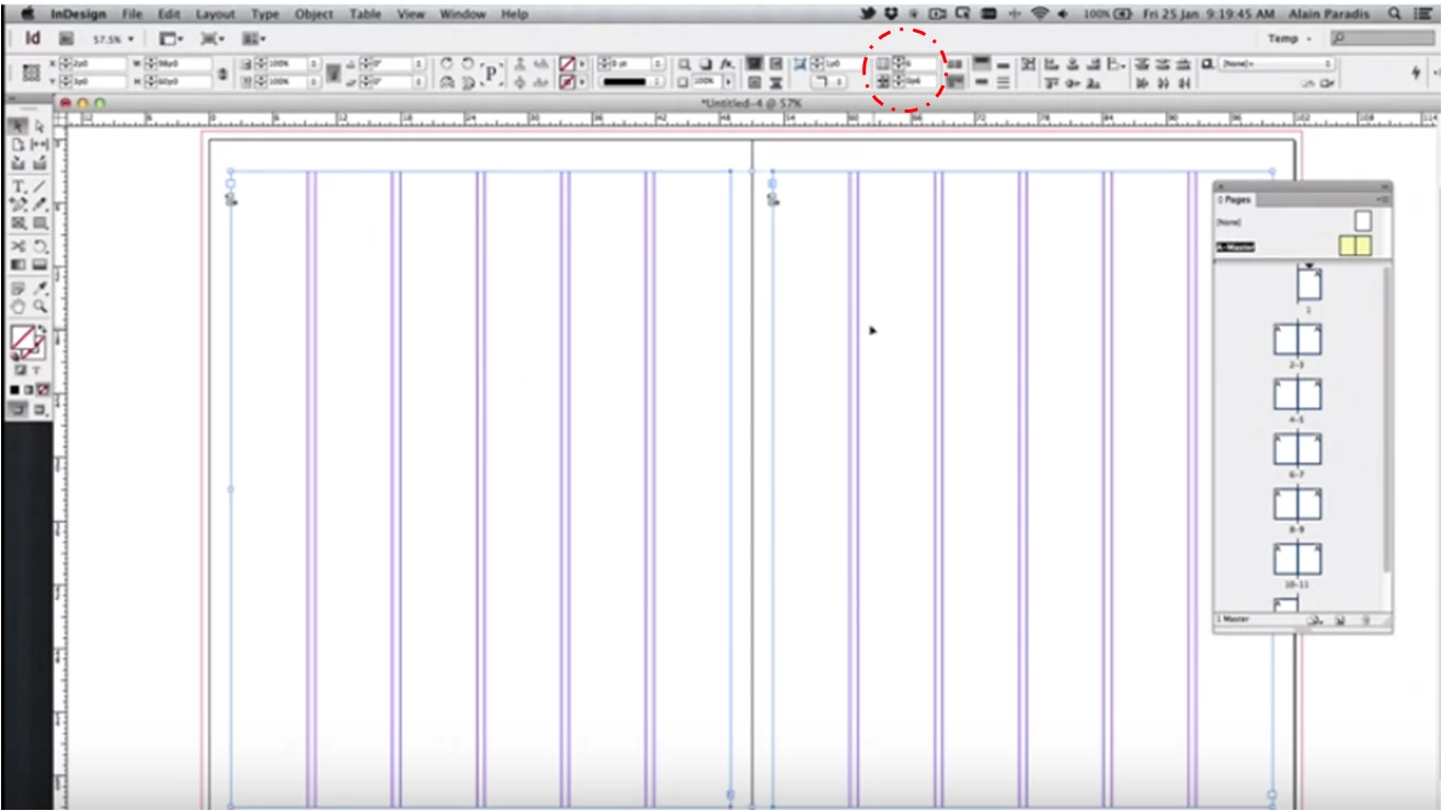

Also, I don't see any menu field/control to control this, like the user did in this YouTube tutorial (skip ahead to about 1 min 55.)
InDesign: Modify a Grid in an Existing Document - YouTube
In this video, you can see he uses the top menu to modify the grid with the controls in the red circle below. BUT these controls don't show up for me, even if I've selected the guides.

Hi dsev1:
That video is demonstrating something that may be different from what you are asking: he is showing how to use primary text frames with a multiple column grid and then, how to edit the grid. It's two steps because the grid is defined in two places: both on the master page and again in the primary frames.
  1. Edit the master page grid via Layout > Margins & Columns and then
  2. Select the primary frames and edit the number of columns to match the page grid via the Control Panel buttons
The button you are asking about is specifically used to change the columns and gutter on the primary frames (and not on the page). If you don't have a text frame selected, it won't be visible. If you do have a text frame selected it still may not be visible because of size/shape of your display. If you don't see the column button when the frames are selected you can:
  1. Edit the buttons on the Control panel to make room, or
  2. Type > Text Frame Options > Number and Gutter (the Control panel buttons are just shortcuts for these two commands):
Now, are you using primary text frames, or are you simply working on a master page grid? If the latter, ignore the video:
