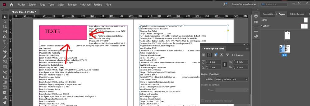

I have tried to do another more simple design in the parent page : a text block inside a rectangle. And I have grouped the text block and the rectangle in order to have a single bloc.
And I have found the way in order to have the text surrounding this object when I am by example on "page 2" : I have selected the object in the parent page and set "text wrapping" to 5 mm around this object.

And here is the result on page 2 :
On this page 2, I don't understand why around the object (created in parent page), I have not the same space around the object (I should have 5 mm all around the object) ?
Mar 16, 2022 Mar 16, 2022
This looks like a case where the bottom of the frame you are wrapping around does not sychronize with the leading applied to the text and the added text wrap amount, so you wind up skipping an extra line. Adjusting the height of that frame (or reducing the text wrap on the bottom) should correct it. You may have to do both to actually get 5mm all around.
