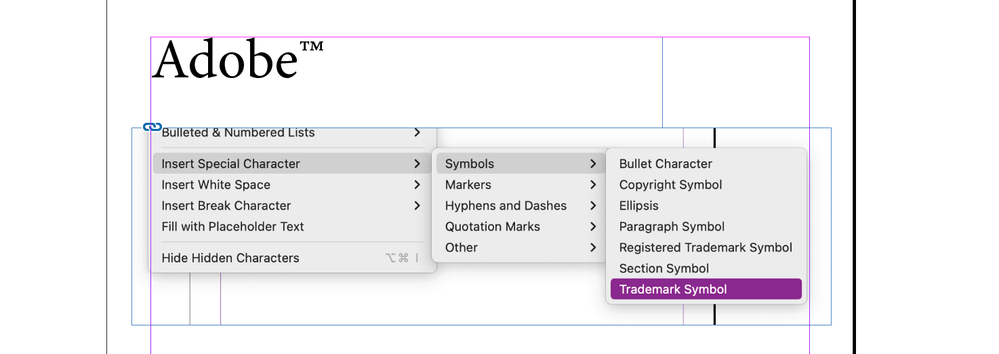

Very simple. Doesn't require GREP. It's a characgter under the Type menu. They are already superscripted:

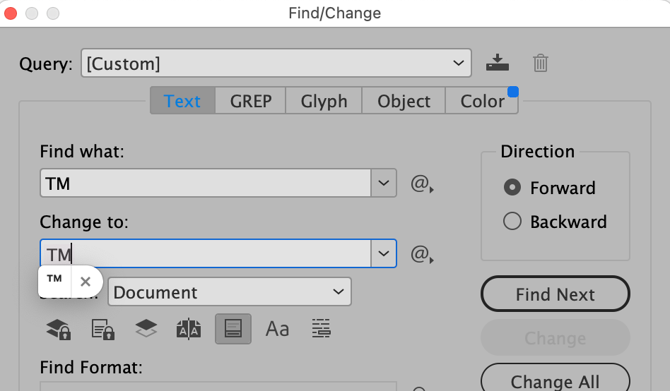

Try this in the regular Find/Change:
The TM (superscripted) can be selected

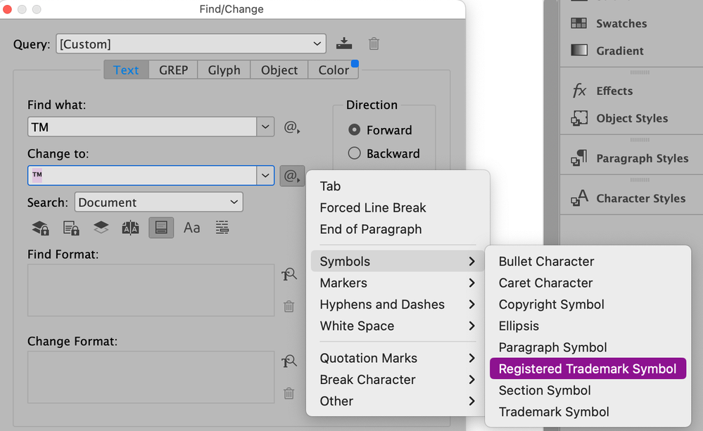

Feb 16, 2023 Feb 16, 2023
Or this if you want a registered trademark in Find/Change:

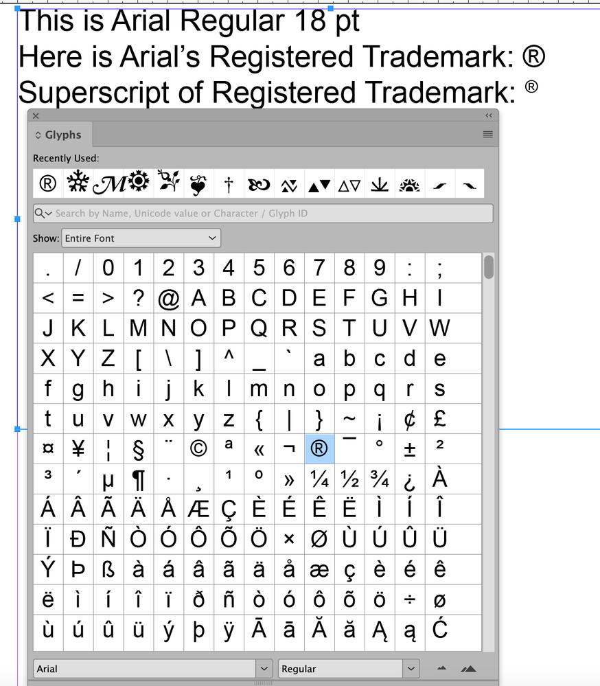

I can do it on my Macintosh with Arial Regular:
