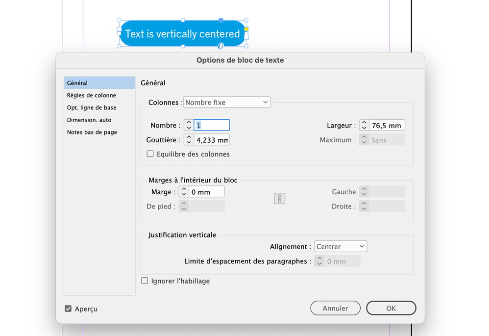

Also, since the text areae is not a rectangle you cannot use any Vertical Justification other than Top
I am not sure:
Apr 19, 2023 Apr 19, 2023
Scott contradicted himself one paragraph later, so I'm not sure if he's right or wrong. 🙂
In the lower example the text is too close to the sides of the text frame and is affected by the curved edges, which is why the alignment for the text is the top of the frame. The only difference between the two frames is width.
