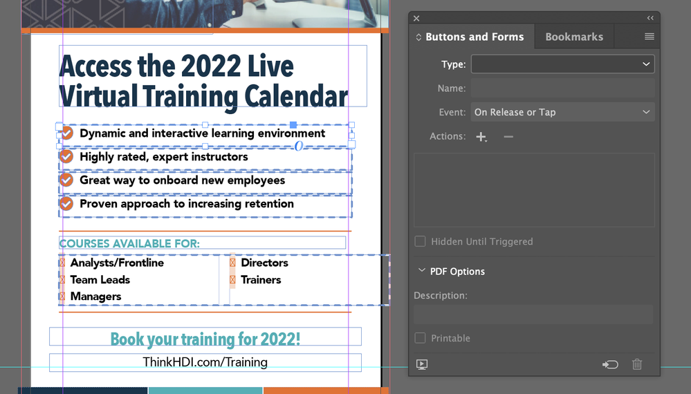

I broke Google. I found a similar question from 2016 in here, but that solution doesn't work. I picked up this job from a designer who is no longer at the company. Does anyone know how to turn off the dashed blue — they are driving me nuts?
Thank you for helping to restore my sanity!
—Dimitry
Nothing in the Buttons window:

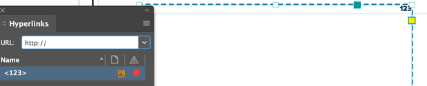

Have you checked the Hyperlinks panel?
Explorer ,
Aug 17, 2022 Aug 17, 2022
I have, no hyperlinks.

Thse text boxes are defined as buttons. If you don't need them for further use (say in a PDF), you can convert them back to plain text boxes: Right click on any of them, and pull down to Interactive > Convert to Object. Thta should clear it.
